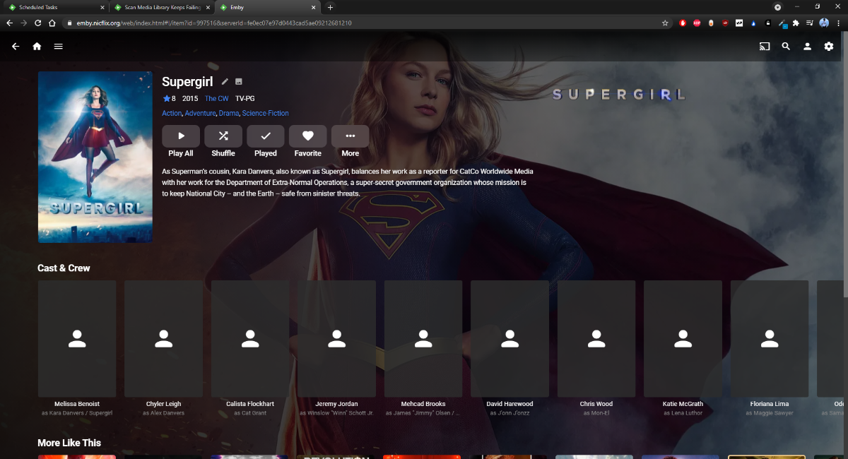

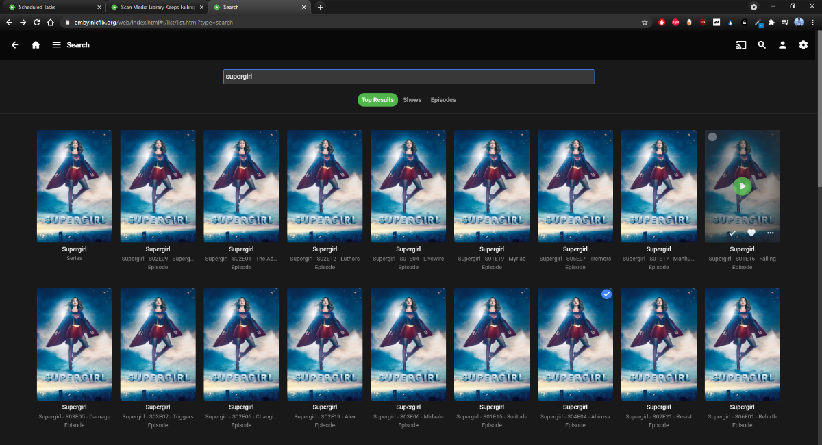

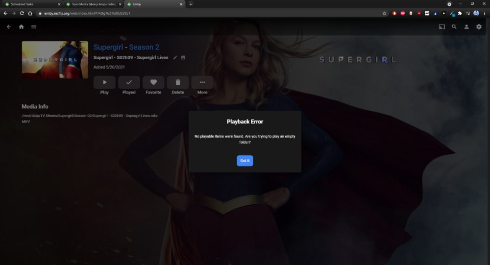

ShadowKindjal 21 Posted May 21, 2021 Author Posted May 21, 2021 On 5/20/2021 at 8:47 AM, Luke said: Possibly that very problem. I would try running a full scan and then let's reevaluate after that. Thanks. Full scan finished late last night but I'm still having issues. Here is an example. I have the show Supergirl on my server. When I search for the show the series populates the results along with all the episodes I currently have downloaded. When I open the series no episodes or seasons are loaded and when I attempt to click on an episode in the search results and play it I get the error that there are no playable items. This is not happening across the board but seemingly randomly. I loaded the file locally in VLC and it plays just fine. I'm also positive that emby has permission to access all the files. Is there something I'm missing?
Happy2Play 9812 Posted May 21, 2021 Posted May 21, 2021 4 minutes ago, ShadowKindjal said: Full scan finished late last night but I'm still having issues. Here is an example. I have the show Supergirl on my server. When I search for the show the series populates the results along with all the episodes I currently have downloaded. When I open the series no episodes or seasons are loaded and when I attempt to click on an episode in the search results and play it I get the error that there are no playable items. This is not happening across the board but seemingly randomly. I loaded the file locally in VLC and it plays just fine. I'm also positive that emby has permission to access all the files. Is there something I'm missing? Can you post a server log, but without Media Info Emby will choke on how to playback.
ShadowKindjal 21 Posted May 21, 2021 Author Posted May 21, 2021 1 minute ago, Happy2Play said: Can you post a server log, but without Media Info Emby will choke on how to playback. Attached is the server log but what do you mean by media info? There seems to be an issue with the metadata populating but the listed location for the episode is correct. embyserver (1).txt
Happy2Play 9812 Posted May 21, 2021 Posted May 21, 2021 6 minutes ago, ShadowKindjal said: Attached is the server log but what do you mean by media info? There seems to be an issue with the metadata populating but the listed location for the episode is correct. embyserver (1).txt 389.78 kB · 0 downloads That log stops where Supergirl is Refreshing, does S02E05 show media info and play? 2021-05-21 15:05:52.450 Info MediaProbeManager: ProcessRun 'ffprobe' Execute: /bin/ffprobe -i file:"/mnt/data/TV Shows/Supergirl/Season 02/Supergirl - S02E05 - Crossfire.mkv" -threads 0 -v info -print_format json -show_streams -show_chapters -show_format -show_data
Happy2Play 9812 Posted May 21, 2021 Posted May 21, 2021 4 minutes ago, ShadowKindjal said: No, it does not Unless it all comes back to this "Could not find a part of the path" but not exactly sure what it is. System.IO.DirectoryNotFoundException: System.IO.DirectoryNotFoundException: Could not find a part of the path '/var/run/s6/services/emby-server/mnt'.

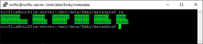

ShadowKindjal 21 Posted May 21, 2021 Author Posted May 21, 2021 Full scan completed but not much changed. I did, however, find that the directory for my metadata seemed to revert back to the default location so that may explain why all my content disappeared. Since new content has been added since this issue begin I merged the two metadata directories into one but I seem to have folders with very similar names in that directory such as "Genre" and "genres". Should I merge folders with similar names like this one and, if so, which folder name should take precedence.
Happy2Play 9812 Posted May 21, 2021 Posted May 21, 2021 10 minutes ago, ShadowKindjal said: Full scan completed but not much changed. I did, however, find that the directory for my metadata seemed to revert back to the default location so that may explain why all my content disappeared. Since new content has been added since this issue begin I merged the two metadata directories into one but I seem to have folders with very similar names in that directory such as "Genre" and "genres". Should I merge folders with similar names like this one and, if so, which folder name should take precedence. Well that is a grey area as Emby is creating bloat with updates. So you can not merge these folders if items contain those paths in the database. So you may have something old pointing to the old path and something new pointing to the new path. People are a good example as some exist in \metadata\library, \metadata\People\a to z folders and now \metadata\people\ no a to z folders. Emby stopped using Custom Genre over a year ago but brought if back with genres. Not postive on Studio/studios, but still back to where the item points to in the database as everything has changed over time old vs new.
ShadowKindjal 21 Posted May 21, 2021 Author Posted May 21, 2021 1 minute ago, Happy2Play said: Well that is a grey area as Emby is creating bloat with updates. So you can not merge these folders if items contain those paths in the database. So you may have something old pointing to the old path and something new pointing to the new path. People are a good example as some exist in \metadata\library, \metadata\People\a to z folders and now \metadata\people\ no a to z folders. Emby stopped using Custom Genre over a year ago but brought if back with genres. Not postive on Studio/studios, but still back to where the item points to in the database as everything has changed over time old vs new. So should I leave them as is and run a server wide metadata refresh instead of a library scan?
