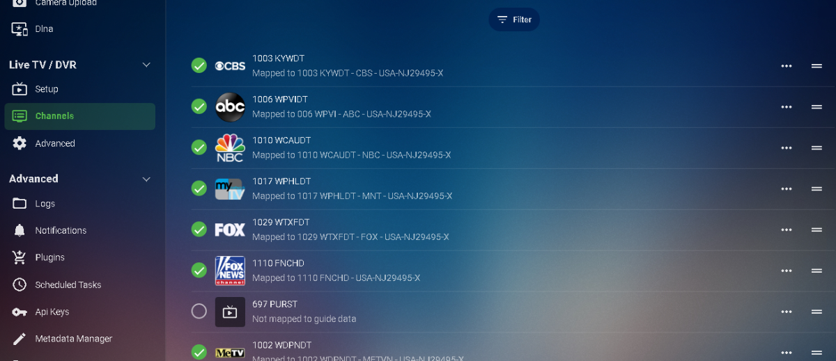

Lepresidente 5 Posted May 20, 2021 Posted May 20, 2021 Hi, I use xteve to sort my channels, so when imported into emby using HDHomeRun its already setup. The default for all devices seems to be "Default channel order", but i would like to use the channel number as default for all devices The new update seems to not take channel number into consideration when sorting channels into the new channel sorter so its out of order.
Carlo 4561 Posted May 20, 2021 Posted May 20, 2021 Hi, Emby now allows you to sort your channel the way you want for each client/user The 2nd option shown is sorting by Channel number. The "default" is what you see/setup as the admin in the new LiveTV/DRV setup->Channels menu option which is new. On this screen you can deactive channel, you can reorder the DEFAULT by drag/drop (6 of my OTA locals dragged to the top above). You can use the 3 dot menu to edit graphics or the channel itself including remapping of guide channels. The new sort order of DEFAULT will use the order you set on this screen. Hope that helps

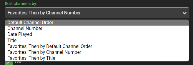

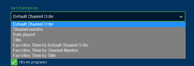

wmichael3 9 Posted September 5, 2022 Posted September 5, 2022 (edited) That does seem to be part of it. If I change the sort order in Google TV to "Last Played", it resets the sort order on an Android phone and in the browser back to "Default Channel Order" If I then change it on the Android phone to Last Played (Date Played is what the UI says), that propagates to the browser, but then Google TV goes back to Default Channel Order. So it seems the Android phone and the web browser are synced, but they reset the channel order on Google TV and vice-versa. So when I look at the sort options between Google TV and Android/Browser, there are 5 sort options for Google TV and 7 sort options for Android/Browser. "Last Played" is the Google TV option and "Date Played" is the label on the equivalent option in the browser and on Android. I'm guessing that this mismatch of sort order options is the culprit. Server is at 4.7.6.0. Android phone is at 3.2.62. Google TV is at 2.0.79g. Edited September 5, 2022 by wmichael3 New info.
Carlo 4561 Posted September 6, 2022 Posted September 6, 2022 In response to @wmichael3 I've tried changing the sort order in a couple clients and none of the changes I made changed or defaulted the web view. I don't have a Google TV device but did try with Android TV and Fire TV. Beyond the issue at hand: Person opinion but I would like to see the same options in all apps and have this saved at the user level not app level. By that I mean if the sort order is change in web it applies to every app I use logged in as me. Since you get used to knowing where a channel "should be" in the list it would be helpful IMHO to be in the same position globally (for that person) regardless of app. IE if you had two favorites (CNN, Fox News) those should be favorites on all apps and if I change the view on any app to "Favorites, Then by Channel Number" I'd expect to see CCN first, Fox News listed second followed by 3,6,10,12, etc in channel order. I wouldn't want to have to repeat the setup on Android TV, Android Mobile, Fire TV and then 4 months later when I happen to use Xbox or Samsung at my son's house. The web view is more refined with additional options for groups/tags to hide/show as well which is great for sports. I can have sports channels in groups NBA, NFL, MLB, NHL groups but only have them showing during parts of the year they are playing in which is fantastic as I don't have to see or scroll through them on the off season. Just doing a brief look between Android TV and Web shows different sort options in both style and choices. If you don't have the same options, you can't do a sort the same way regardless of if it's an app or user setting. Android TV for example has these choices in a drop down: Default Channel Order Last Played Channel Number Name Play count Then it also has a checkbox "Place favorites at beginning." Web only has a dropdown list but not matching counter parts. No "Favorites, Date Played" One has "Last Played" and one has "Date Played". Android TV has an extra option as well for Play count so if chosen can't be duplicated on other apps.
