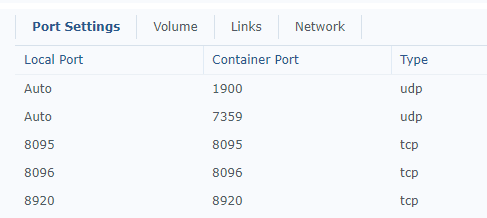

freaksed 0 Posted May 20, 2021 Author Posted May 20, 2021 (edited) It is using the bridge and below is the port settings. When i check the 8095 and 8920 ports at https://canyouseeme.org they show as available Edited May 20, 2021 by freaksed
Luke 42243 Posted May 21, 2021 Posted May 21, 2021 1 hour ago, freaksed said: It is using the bridge and below is the port settings. When i check the 8095 and 8920 ports at https://canyouseeme.org they show as available Does your server dashboard display the correct remote address?
freaksed 0 Posted May 21, 2021 Author Posted May 21, 2021 no for some reason 8096 doesnt show publicly even though its forwarded. but in emby settings 8095 is the external port
Luke 42243 Posted May 21, 2021 Posted May 21, 2021 14 hours ago, freaksed said: no for some reason 8096 doesnt show publicly even though its forwarded. but in emby settings 8095 is the external port Then you must have changed it in emby network settings from 8096 to 8095? Why? this is ok but you're just making things more difficult. Now you have to go all the way up through the chain from the container to the router to make sure 8095 is open at each level and forwarding properly. Whereas out of the box, the server will try to set this up on 8096 for you.
