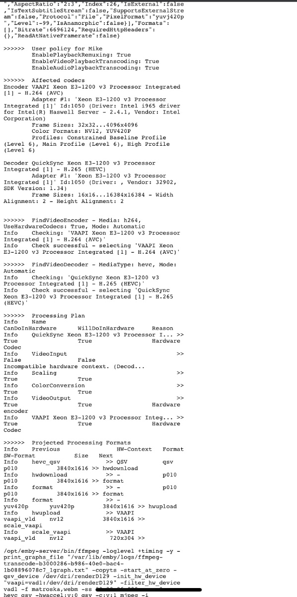

mike3821 67 Posted May 18, 2021 Posted May 18, 2021 So I did a pass through of my xenon-1200 v3 video card and attached it to the VM of Ubuntu. it sees the device via lspci and Emby sees it in the options for transcoding but it fails to software with errors in the log files.
mike3821 67 Posted May 18, 2021 Author Posted May 18, 2021 (edited) I pulled this from the log. Edited May 18, 2021 by mike3821
Luke 42246 Posted May 18, 2021 Posted May 18, 2021 Hi, please attach the original log files rather than a screenshot of the log file. Thanks.
mike3821 67 Posted May 18, 2021 Author Posted May 18, 2021 ffmpeg-transcode-.txt ffmpeg-transcode-.txt

Q-Droid 1011 Posted May 19, 2021 Posted May 19, 2021 I could be wrong but I think this is a hardware detection problem. As far as I know Haswell CPUs do not have hardware support for HEVC but this session is attempting to do just that.

Q-Droid 1011 Posted May 19, 2021 Posted May 19, 2021 That CPU definitely supports h.265 up to 10-bit and definitely 4k even for multiple simultaneous streams. From the log it looks like the session that failed was HEVC 10-bit. So what you could to as a test, to see if your CPU can handle it, is go in Transcoding -> Advanced and disable the HEVC Decoder so that it tries decode in software but encode in HW. The CPU might choke or at least get pegged for a while. Still would like to know what the devs have to say about the errors you got.
