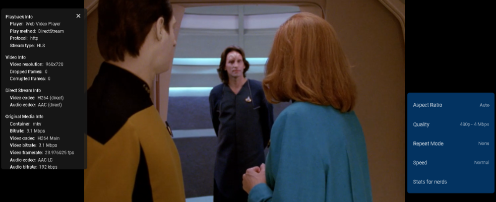

TeamB 2440 Posted May 19, 2021 Author Posted May 19, 2021 Latest version of firefox. Latest edge browser did not have the problem but it was reporting direct play instead of dirrct stream in stats for nerds

Carlo 4561 Posted May 19, 2021 Posted May 19, 2021 I tested with firefox 88.0.1 and Emby Server 4.6.0.48 I jumped to about 7 minutes left and let it play in firefox and it played just fine (direct streamed). I did this a couple of different times and it always played. The only "issue" for me is QUALITY choice that show up on the Cog menu. The higherst I could set it is "480o-4Mbps" and the video is 720.
