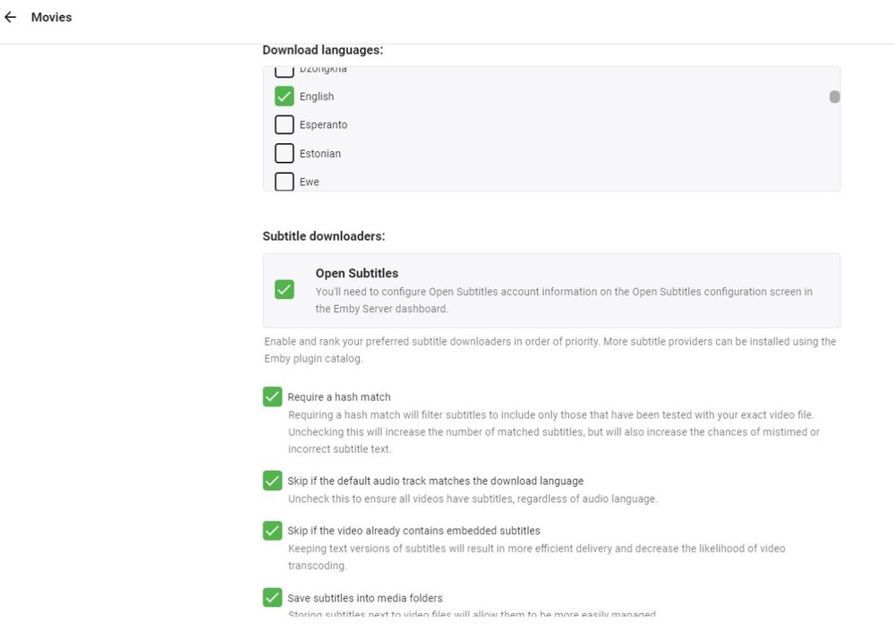

Carlo 4561 Posted May 17, 2021 Posted May 17, 2021 Can you show us your library settings for the subtitle section with advanced options turned on? A screen shot or two would be good. You could also try to a search and upload your log file so we can look at it. Just tell us what movie you used.
jsc1205 51 Posted May 17, 2021 Author Posted May 17, 2021 8 minutes ago, cayars said: Can you show us your library settings for the subtitle section with advanced options turned on? A screen shot or two would be good. You could also try to a search and upload your log file so we can look at it. Just tell us what movie you used. Are are the 2 screen shots for subtitle settings as well as log file. embyserver.txt
Luke 42203 Posted May 17, 2021 Posted May 17, 2021 It looks like it just didn't find a match. How is the video file and folder named?
Carlo 4561 Posted May 17, 2021 Posted May 17, 2021 "Require a Hash Match" is my guess as well. I can't use that on any of my files as they are all rips or I've reprocessed them so I'll never get a match.

Carlo 4561 Posted May 17, 2021 Posted May 17, 2021 No, try turning off the option "Require a Hash Match" Then try it again.
jsc1205 51 Posted May 17, 2021 Author Posted May 17, 2021 1 minute ago, cayars said: No, try turning off the option "Require a Hash Match" Then try it again. Ok just did that and still nothing
