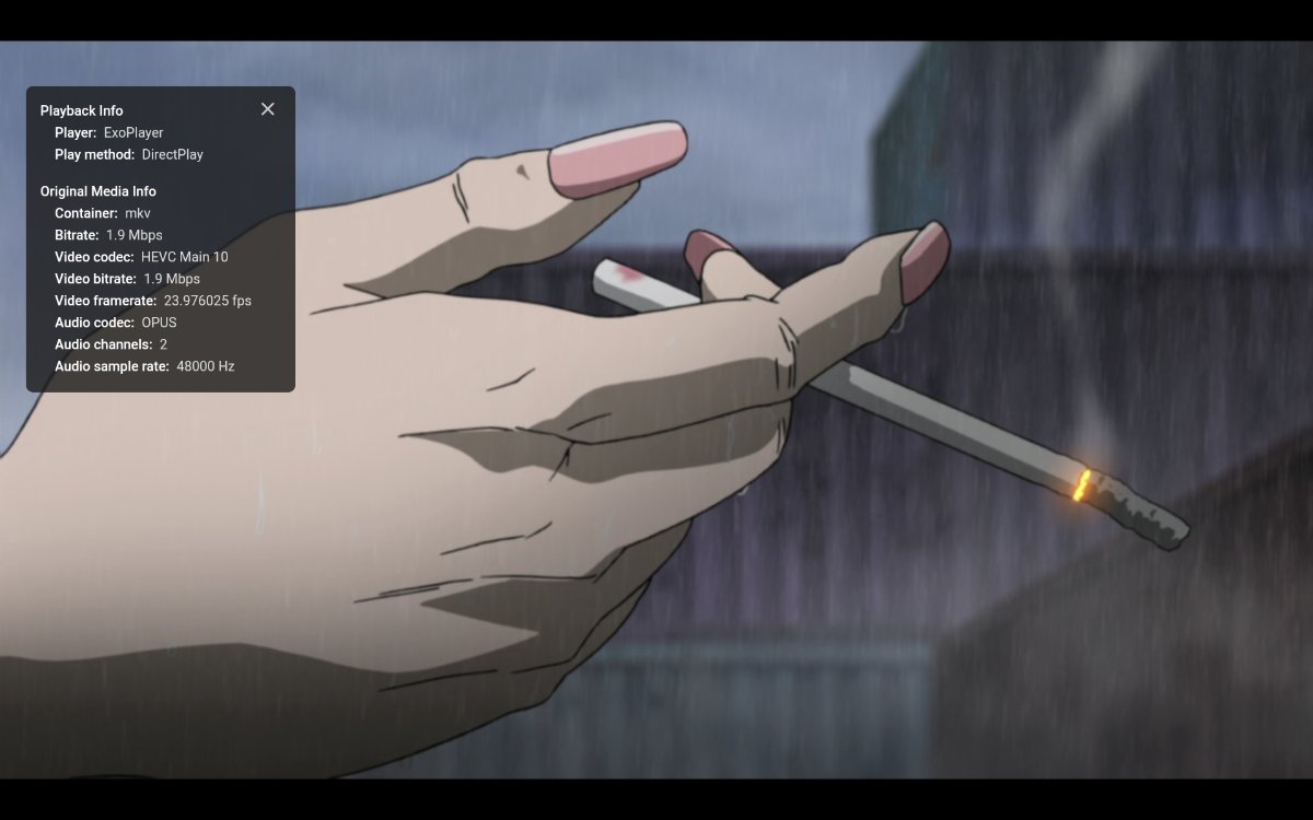

cavalist 1 Posted May 19, 2021 Author Posted May 19, 2021 13 hours ago, cayars said: What media did you play? [Judas] Black Lagoon - S01E14.mkv 317MB screenshot is the tablet playing the video. problem is not just for this video. regardless of videos, there is lagging.

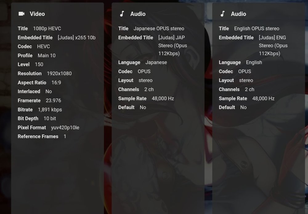

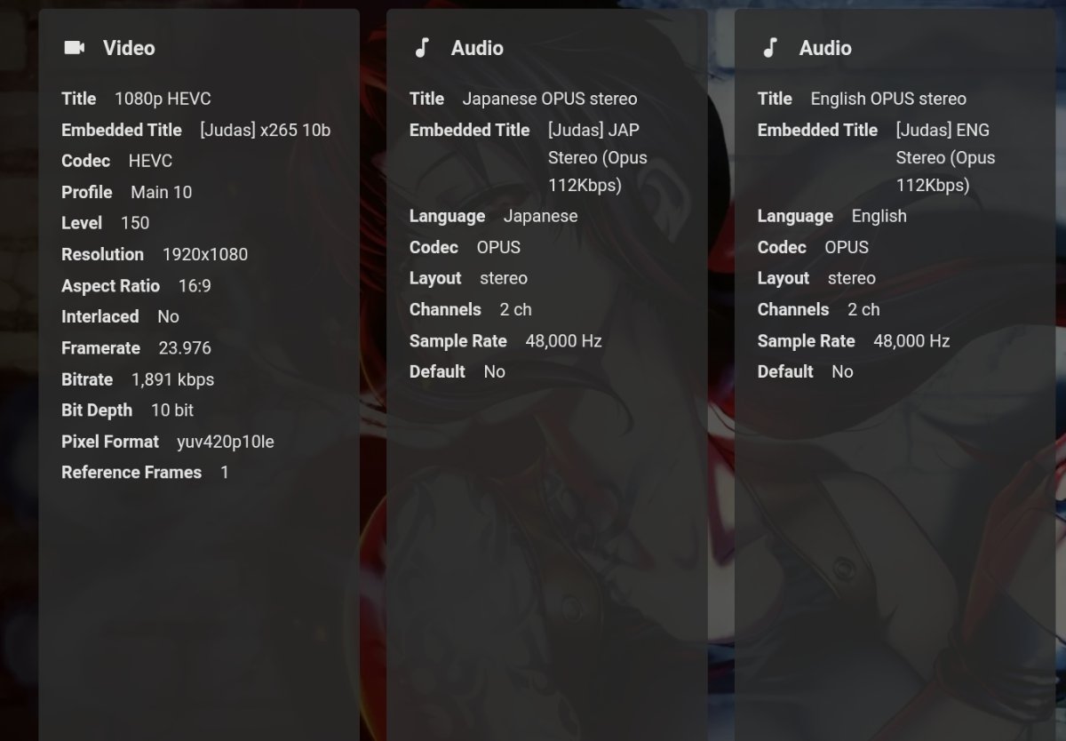

Carlo 4561 Posted May 19, 2021 Posted May 19, 2021 Can you post the MEDIA INFO section of one of these files please? It will be at the bottom of the detail screen.
Solution Carlo 4561 Posted May 19, 2021 Solution Posted May 19, 2021 If I'm right I think you might be trying to play back 10 bit HVEC files which isn't going to work well on that tablet only having a Snapdragon 410 processor. To playback 10 bit HEVC with hardware decoding you really need at least a Snapdragon 820. 1
cavalist 1 Posted May 19, 2021 Author Posted May 19, 2021 22 minutes ago, cayars said: Can you post the MEDIA INFO section of one of these files please? It will be at the bottom of the detail screen.
Carlo 4561 Posted May 19, 2021 Posted May 19, 2021 Thought that might be the issue. What you can try doing when using that tablet playing these 10 bit files is force transcoding (assuming your server handles this well) either by lowering the bit rate or using the playback correction both available on the COG menu in the OSD during playback. 1
