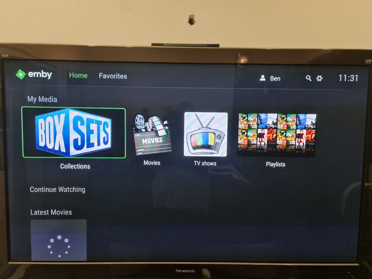

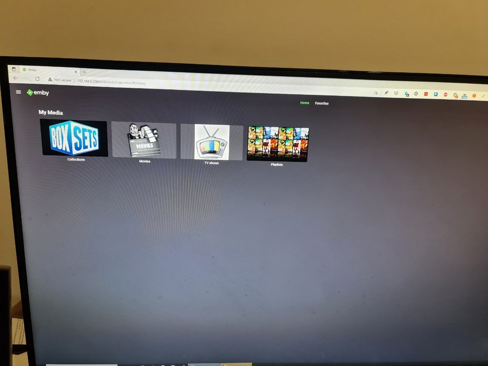

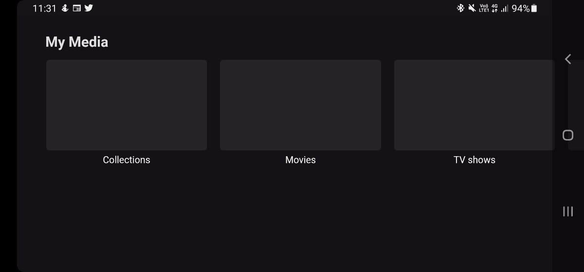

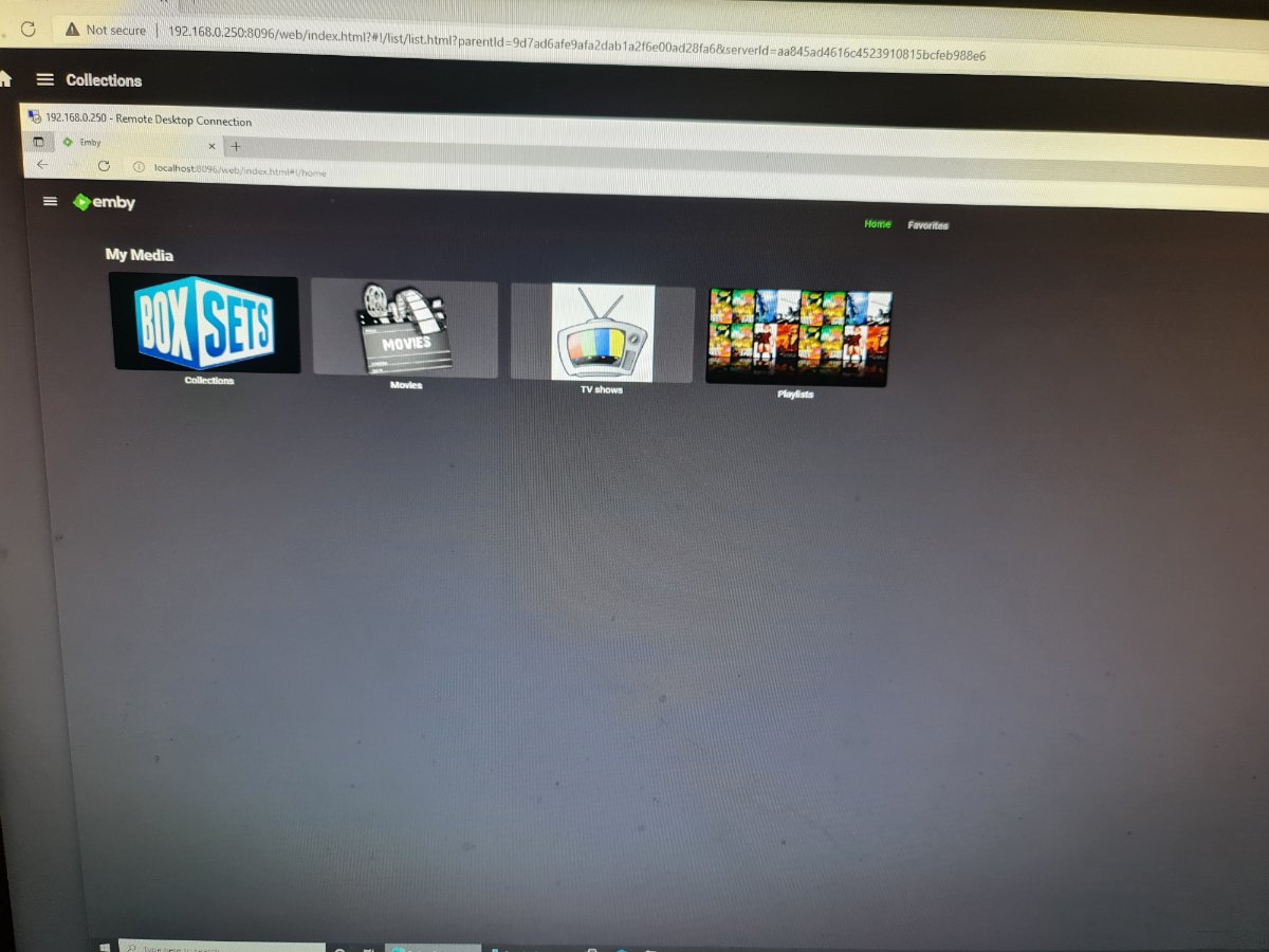

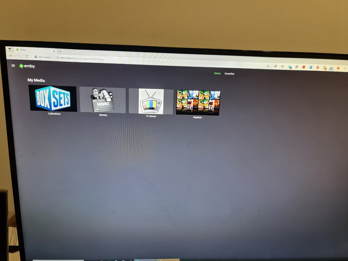

gimpacause 3 Posted June 5, 2021 Author Posted June 5, 2021 Hi Luke When I or anyone else opens emby all we can see is My Media, and nothing else, can't see latest TV/Movies or Continue Watching, clicking on Collections/Movies/TV Does nothing just sits there I did let it sit for about 15 minutes from another PC on the network (Web browser) and everything showed up, clicked on a movie started playing instantly and the screen froze, I could still see and click the OSD Buttons but nothing happens on each input Checking both systems (The NAS & Windows PC Running Emby) they don't seem to be using any CPU/RAM/DISK Here's some photos from several device's I have so far checked my network infrastructure speed and couldn't see any issues Thanks, Ben

Carlo 4561 Posted June 5, 2021 Posted June 5, 2021 Try running a full library scan. Also check your home page settings as you can change what shows up that way.
gimpacause 3 Posted June 5, 2021 Author Posted June 5, 2021 (edited) hi cayars, started a full library scan a few minutes after your post, its about 95% done (this is very slow compared to other times) looking in other threads I have confirmed extract thumbnails gtom media files is DISABLED I have also noticed quite a few TV shows are also missing from the library when i can get it load, I'll leave it for now and let it complete the library scan and report back what happens, thanks for all the help Edited June 5, 2021 by gimpacause
Luke 42203 Posted June 5, 2021 Posted June 5, 2021 Let us know that it looks like once the scan is complete. Thanks.
gimpacause 3 Posted June 7, 2021 Author Posted June 7, 2021 Hi Luke everything appears to be back and running normally, can't test it all at the moment due to my NAS doing its monthly RAID resync/Check, I will mark as solved once I can play around with it a bit, thank you all for the help thus far 1
