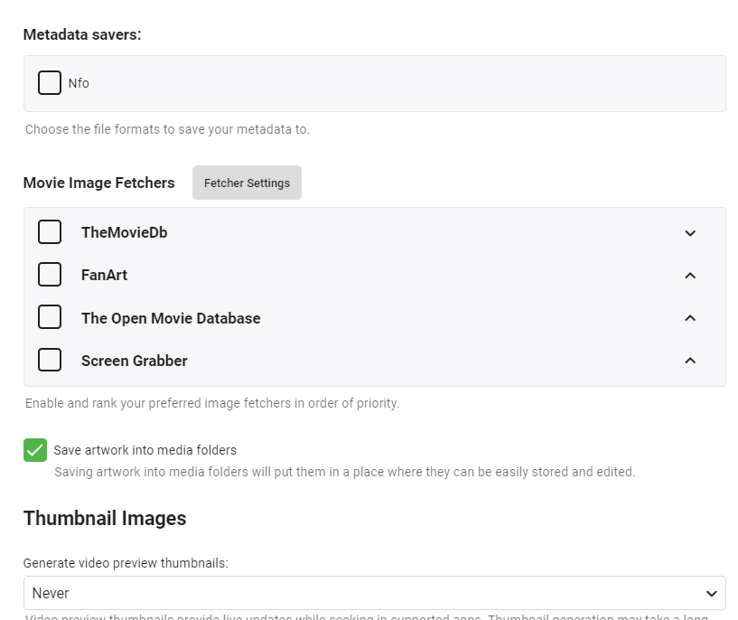

AxeMan 25 Posted May 14, 2021 Posted May 14, 2021 Hi - I'm looking at having two Emby servers... I recall seeing a thread that you'd set one as a "read-only" for the metadata... I'd like to do this: MOVE data from my OLD Emby Server to my NEW server. Then, make the NEW one the production machine, and the OLD one the "read-only" one. Is this as simple as using the backup plug-in, restore on the new server, then going back to the old one, and changing the library settings and unchecking ALL the metadata sources and savers? Like so?

Carlo 4561 Posted May 14, 2021 Posted May 14, 2021 You can most certainly use your same license on 2 servers so that's not an issue. Ideally when recording you want to do that to a local drive as well. I'm not however behind the idea of one read and one write, but it depends how you plan to use these two systems. To give you an idea I presently have 4 Emby servers pointing to the same data, all with read/write permissions and have no issues in doing so. I keep the versions the same.
AxeMan 25 Posted May 14, 2021 Author Posted May 14, 2021 6 minutes ago, cayars said: You can most certainly use your same license on 2 servers so that's not an issue. Ideally when recording you want to do that to a local drive as well. I'm not however behind the idea of one read and one write, but it depends how you plan to use these two systems. To give you an idea I presently have 4 Emby servers pointing to the same data, all with read/write permissions and have no issues in doing so. I keep the versions the same. Wait, do they all run media scans and attempt metadata fetch? Or do they recognize the metadata is there and just skip over it?
Carlo 4561 Posted May 14, 2021 Posted May 14, 2021 So I have my libs set to store NFO and graphics in the media libraries. So all instances will use the same graphics and pull in info based on the NFO file. Other than that they are independent system. Metadata isn't shared between servers so a refresh on one machine is just on that machine. Matter of fact I'm doing a full metadata refresh (not replacing images) as I type this.
