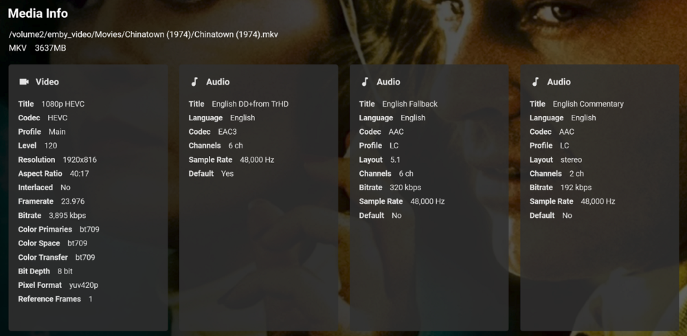

roaku 842 Posted May 14, 2021 Posted May 14, 2021 (edited) EAC3 content that used to direct play is now remuxing to AC3. I suspect the 10.0.0 Roku release has struck again. Edit: My Roku Audio mode is 'Auto (DD+, DTS-HD))' The SFN Transcoding reason given for me is 'Audio channels not supported', but they certainly used to be. Edited May 14, 2021 by roaku 1

speechles 2062 Posted May 14, 2021 Posted May 14, 2021 @roaku The Roku TV reports the following for E-AC3: Brightscript Debugger> ?device.CanDecodeAudio({codec: "eac3"}).result true Brightscript Debugger> ?device.CanDecodeAudio({codec: "eac3", ChCnt: 8}).result true How many channels is the E-AC3 audio you are attempting to play on your Roku? What model number of Roku is this?
roaku 842 Posted May 14, 2021 Author Posted May 14, 2021 6 channels 4670x 10.0.0 build 4195-46 The EAC3 itself was generated by Handbrake converting from a TrueHD source.
speechles 2062 Posted May 14, 2021 Posted May 14, 2021 (edited) @roaku Roku might have changed something in version 10.x. If it says the Audio Channel Count isn't supported that is what it thinks is happening. We send requests for 6 channel and 2 channels to the device for support queries. We first query for codec support. If the codec is found supported we query for channel support. We query for 6 channel support first and if that returns false we check for 2 channel support and if that also returns false we fallback to disable that codec. The codec is not being disabled. It says the channel count is too high. It says only 6 channel EAC3 in your media information from the server. Your Roku device 4670 can support that, but the entire HDMI chain must support it too, the Roku must know it can. You might try to unplug the Roku and plug it back in. Maybe it got bad HDMI detection and things weren't all turned on for it to properly detect? The Roku only does the HDMI detection during boot up. After that the queries just return stored responses from that initial boot up. Edited May 14, 2021 by speechles

ebr 16334 Posted May 14, 2021 Posted May 14, 2021 Try turning off the option to convert AAC audio and see what happens...
roaku 842 Posted May 14, 2021 Author Posted May 14, 2021 9 minutes ago, ebr said: Try turning off the option to convert AAC audio and see what happens... That worked. Direct play is happening again. Thanks. That being said, I've always had the Convert AAC audio option enabled and use it for some content and previously there was no conflict with my EAC3 content. Is this something that can be fixed or is it the new normal?
ebr 16334 Posted May 14, 2021 Posted May 14, 2021 4 minutes ago, roaku said: Is this something that can be fixed or is it the new normal? It is a bug in the app. It is looking at that option for DD+ when it shouldn't be. 1
