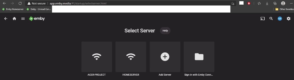

Happy2Play 9802 Posted May 12, 2021 Posted May 12, 2021 Don't quite follow, unless this is a client issue as app.emby.media shows both for me. Two server same network
