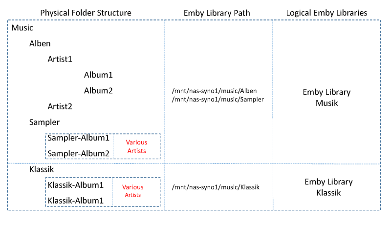

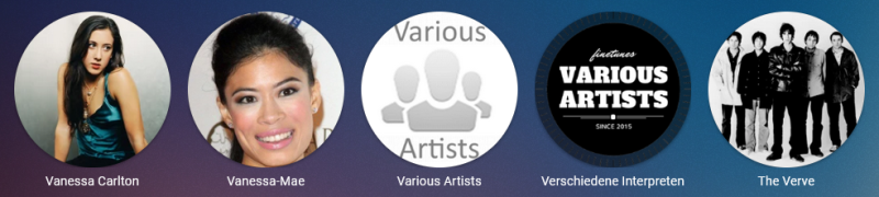

fxwegr 6 Posted May 12, 2021 Posted May 12, 2021 I have the following problem with the Emby server, which is incomprehensible to me: In the Emby display "Artists" or "Album Artists" I find, inexplicably for me, the artist "Verschiedene Interpreten" as well as the artist "Various Artists". However, all the albums/titles in question are correctly and uniformly tagged with "Various Artists" (MP3 tags). The problem does not occur with all other artists. How does this happen? How can I merge the titles that are tagged with "Various Artists" under one artist? Attached the library structure I used.

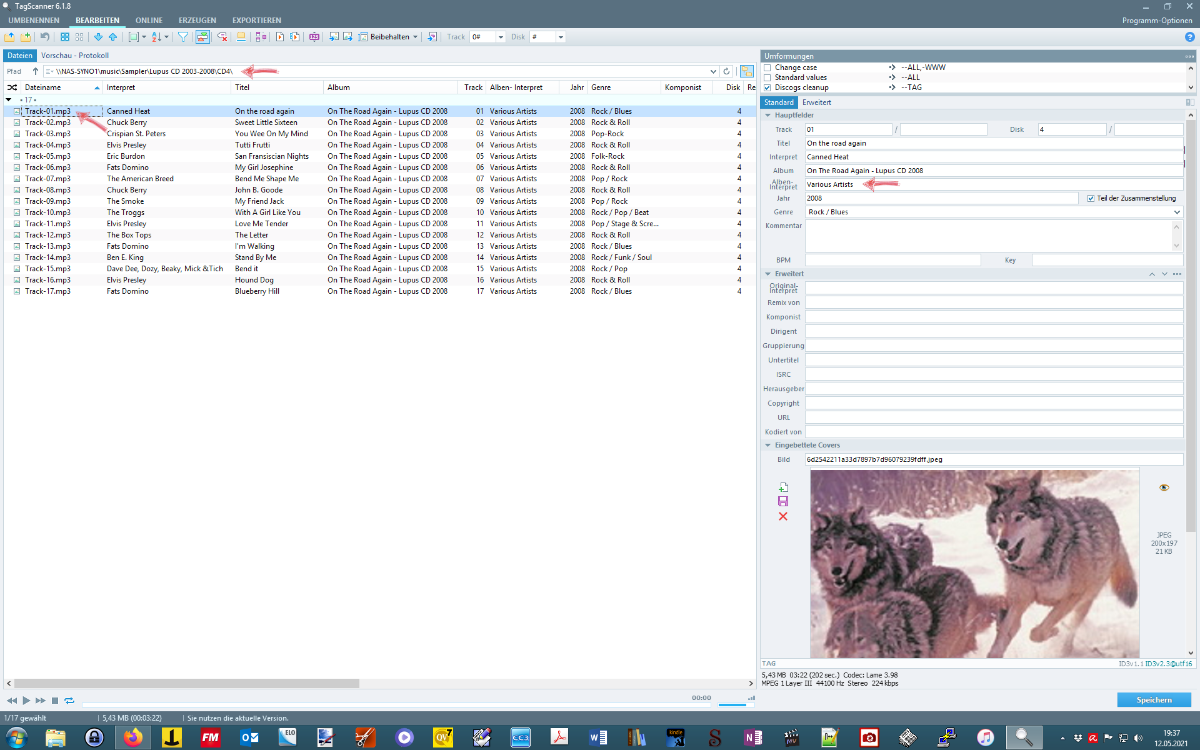

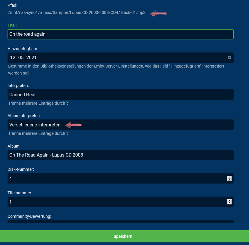

fxwegr 6 Posted May 12, 2021 Author Posted May 12, 2021 Hi Luke I think in the meantime it is a problem for the Emby developer. I have attached two screenshots: One shows one of my problematic audio files and its tags, the other shows the associated Emby metadata. Please have a look at it. I think the problem is with the database and its management.

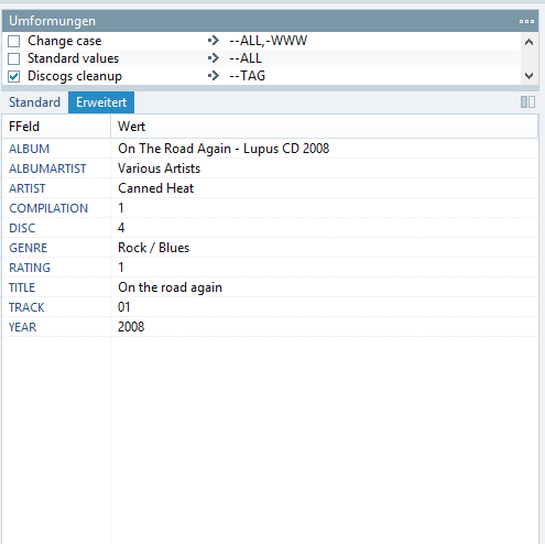

Guest Posted May 12, 2021 Posted May 12, 2021 What does it show under 'Erweiterte' next to 'Standard'? I also show the tags @UTF-16 instead of UTF-8... I have seen issues with the tags being read properly in this format.. Can you upload the file here for a test? As an attachment?
fxwegr 6 Posted May 12, 2021 Author Posted May 12, 2021 Below is what is displayed under "Erweiterte". Also the files for a test. Thank you for your interest. CD4.zip

fxwegr 6 Posted May 14, 2021 Author Posted May 14, 2021 I have carried out the suggested tests - without success. I could not find the cause of the problem, but I was able to find a workaround. Again the description of the situation: Emby recognises a total of 57 sampler albums. For all sampler albums the albumartist ID3-tag is set to "Various Artists". From this inventory Emby generates two different Albumartists namely: Various Artists and Verschiedene Interpreten 3 albums are assigned to the albumartist "Various Artist". The album artist "Verschiedene Interpreten" is assigned 54 albums. In the case of various albums, I could see that individual traks of this album were assigned to the albumartist "Verschiedene Interpreten", but others were assigned to the albumartist "Various Artists". So the album was split between two different albumartists. The workaround: I changed the ID-3 tag "Album Artist" of the 3 albums that were assigned to the albumartist "Various Artists" from "Various Artists" to "Verschiedene Interpreten" and rescanned the library. After that, all sampler albums were under the album artist "Verschiedene Interpreten". The album artist "Various Artists" had disappeared. The whole thing looks very strange. I have the strong impression that the Emby logic is not quite clean at this point. Thanks you for all your help.

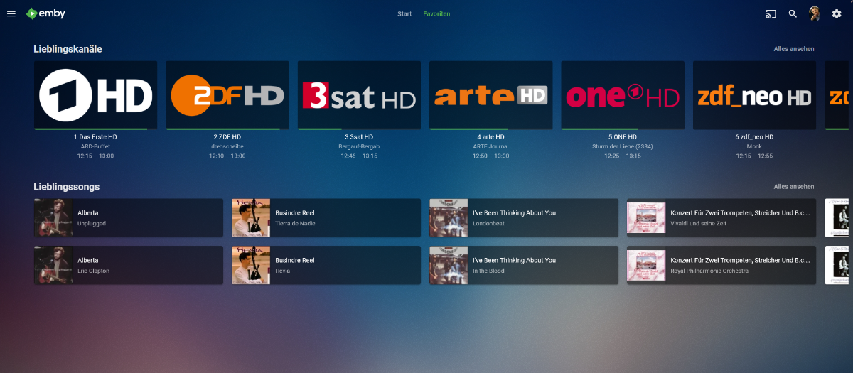

fxwegr 6 Posted May 26, 2021 Author Posted May 26, 2021 Hi Luke, regarding the problems reported in this thread, everything looks good. However, I have noticed a new problem: In the favourites, the favourite songs are displayed twice. Please have a look at the attached screenshot. Regards

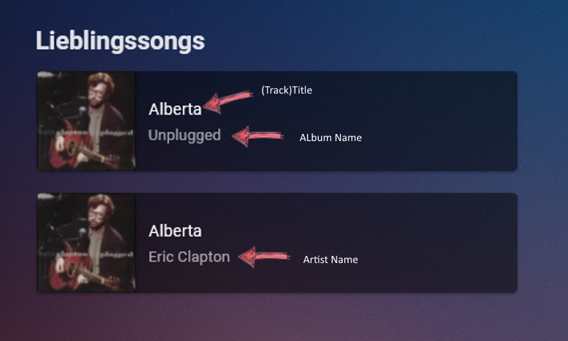

fxwegr 6 Posted May 26, 2021 Author Posted May 26, 2021 The fullscan does not change the situation. It looks like emby creates for an album track one entry for the album name, and a second entry for the album artist. Please have a look at the attached screenshot
fxwegr 6 Posted May 27, 2021 Author Posted May 27, 2021 This is for your information: I have unliked all favorite songs and re-liked one song. This was then also double. Apparently this has nothing to do with old entries in the database. Regards.

fxwegr 6 Posted May 27, 2021 Author Posted May 27, 2021 If all favorite songs have been removed and none are displayed, then the database should also be clean. Emby can only display something if this is also present in the corresponding DB table. If I then like a new song and it is displayed twice, this indicates an algorithmic problem. Twice is not a precise term here: Two favorites entries are displayed for one song, but they have different information content. If I like a song that has never been in my favorites before, it will also be shown twice. There can't be any old DB content here.
