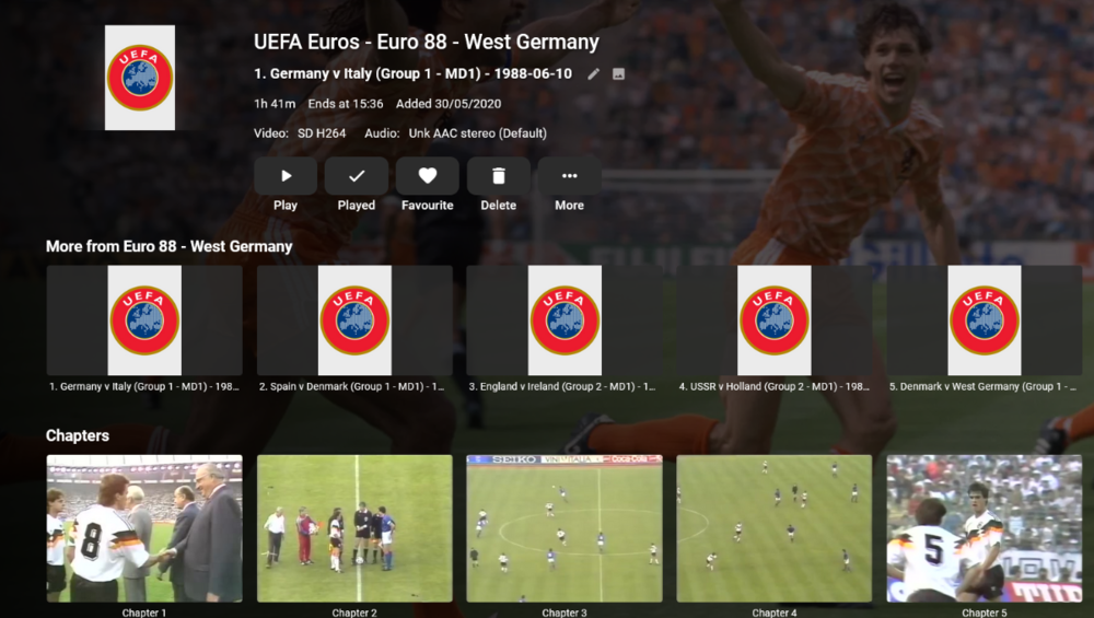

bigembyfan 69 Posted May 9, 2021 Posted May 9, 2021 (edited) Hi, I have a couple of sports related libraries with matches I've recorded from TV, when setting them up in libraries I have the library set to use 'Thumbnail Images' (Generate video preview thumbnails = 'as a scheduled task and when media is added'), I can see this works great in the 'Chapters' part of an entry (ie a match) but the screenshots aren't used for the entry itself, instead the main image for the top level item is used (see screenshot attached). The absolute ideal would be to be able to select one of the chapter images as the main image for the entry - is this possible at all? Should I be seeing one of those thumbnails in place for the entry / match? I could obviously do this all manually by navigating to the generated images and adding the one I want for each match via the metadata image selection but this would be a bit of a slog so hopefully there's an easier way! Thanks Edited May 9, 2021 by bigembyfan

Solution Happy2Play 9840 Posted May 9, 2021 Solution Posted May 9, 2021 Screen grabber should be providing a episode thumb if not provided by provider, do you have it enable? 1
bigembyfan 69 Posted May 10, 2021 Author Posted May 10, 2021 Hi Happy2Play, I think the problem might have been because I added the large bulk of the files in the 2 libraries when I had 'Never' selected for 'Generate video preview thumbnails' for both? Or am I missing a separate setting to enable Screen grabber? I have since enabled that by selecting 'As a scheduled task and when media is added', Emby Server then worked through creating all the Chapter images for all items which worked perfectly. However, all the library items just fallback to the top level 'TV Show' thumbnail I've added (see the screenshot in my initial post above which shows the UEFA Euro poster for all items). I've tried rescans including updating images but that hasn't done it (I assume that's just relevant when the images are downloaded externally like for movies?) - It sounds like I'll have to manually go through and update those or start again with the 2 libraries. When browsing via the web browser they show the screenshot above, when browsing via the AppleTV app they show no thumbnail at all, just a blank black placeholder. Both libraries in question are configured as 'TV shows'.
bigembyfan 69 Posted May 10, 2021 Author Posted May 10, 2021 (edited) Sorry! I was being very blind, I didn't realise that 'Screen Grabber' was one of the options in 'Episode Image Fetchers', I had all those unticked because I knew there'd be no match with any external image fetcher on the files in these libraries. I've just enabled the 'Screen Grabber' option for 'Episode Image Fetchers' on those libraries and rescanned and now seeing episode images which is great, yet again Emby offering exactly what is needed once the settings are correct, you guys have done a great job. The selection of one of the other Chapter images would be a nice addition as stated in the feature request but my main issue is sorted now. Edited May 10, 2021 by bigembyfan 1
