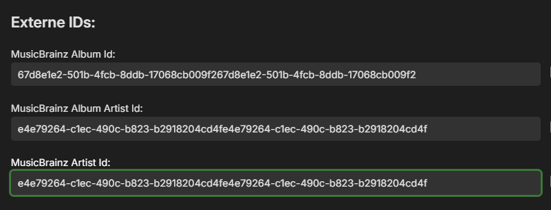

mad3all 1 Posted August 8, 2024 Posted August 8, 2024 (edited) Moin, I am new to emby. Today I tried to import my music library and got the same problem. My ffprobe output for two examples shows the same result. The only difference is that the artist is not the same. After seeing that emby set a 'compilation' tag for the one different piece, I specifically set it to '0' for all of them. Here is the ffprobe output: PS C:\Users\dirkg> ffprobe -i "E:\# Eigene Dateien\Musik\wumpscut\Born Again\1-12 - Embryodead (Cockroach Modified).mp3" ffprobe version N-116546-g792a9979eb-20240807 Copyright (c) 2007-2024 the FFmpeg developers built with gcc 14.1.0 (crosstool-NG 1.26.0.93_a87bf7f) ... [mp3 @ 0000025a2e437880] Estimating duration from bitrate, this may be inaccurate Input #0, mp3, from 'E:\# Eigene Dateien\Musik\wumpscut\Born Again\1-12 - Embryodead (Cockroach Modified).mp3': Metadata: album : Born Again artist : :wumpscut: album_artist : :wumpscut: iTunNORM : 000005DF 00000000 00001DC8 00000000 0001ADF5 00000000 00007680 00000000 0002BF37 00000000 composer : Rudi Ratzinger disc : 1 genre : Industrial compilation : 0 TLEN : 272927 MusicBrainz Album Artist Id: e4e79264-c1ec-490c-b823-b2918204cd4f title : Embryodead (Cockroach Modified) track : 12 MusicBrainz Album Id: 67d8e1e2-501b-4fcb-8ddb-17068cb009f2 artist-sort : wumpscut MusicBrainz Non-Album: 0 MusicBrainz Album Status: official MusicBrainz Album Type: album TAGGINGTIME : 2007-01-26T01:37:19 MusicBrainz Artist Id: e4e79264-c1ec-490c-b823-b2918204cd4f ALBUM ARTIST : :wumpscut: MusicBrainz Album Artist: :wumpscut: MusicBrainz Album Artist Sortname: wumpscut MusicBrainz Album Release Country: DE date : 1997 Duration: 00:04:32.94, start: 0.000000, bitrate: 128 kb/s Stream #0:0: Audio: mp3 (mp3float), 44100 Hz, stereo, fltp, 128 kb/s Stream #0:1: Video: mjpeg (Baseline), yuvj420p(pc, bt470bg/unknown/unknown), 250x248 [SAR 1:1 DAR 125:124], 90k tbr, 90k tbn (attached pic) Metadata: comment : Cover (front) PS C:\Users\dirkg> ffprobe -i "E:\# Eigene Dateien\Musik\wumpscut\Born Again\1-13 - Vaporize (Wumpscut Remix).mp3" ffprobe version N-116546-g792a9979eb-20240807 Copyright (c) 2007-2024 the FFmpeg developers built with gcc 14.1.0 (crosstool-NG 1.26.0.93_a87bf7f) ... [mp3 @ 00000262fd8a8480] Estimating duration from bitrate, this may be inaccurate Input #0, mp3, from 'E:\# Eigene Dateien\Musik\wumpscut\Born Again\1-13 - Vaporize (Wumpscut Remix).mp3': Metadata: album : Born Again artist : :wumpscut: album_artist : :wumpscut: composer : Rudi Ratzinger disc : 1 genre : Industrial compilation : 0 TLEN : 310055 title : Vaporize (:Wumpscut: Remix) track : 13 iTunNORM : 000007CD 00000000 00003362 00000000 000138C5 00000000 00008000 00000000 0002BF37 00000000 MusicBrainz Artist Id: e645aa86-3458-4de8-a07a-f5602070d2e1 ALBUM ARTIST : :wumpscut: MusicBrainz Album Artist: :wumpscut: MusicBrainz Album Artist Sortname: wumpscut MusicBrainz Album Release Country: DE MusicBrainz Album Artist Id: e4e79264-c1ec-490c-b823-b2918204cd4f MusicBrainz Album Id: 67d8e1e2-501b-4fcb-8ddb-17068cb009f2 artist-sort : Aghast View MusicIP PUID : MusicBrainz Album Type: album MusicBrainz Album Status: official MusicBrainz Non-Album: 0 TDTG : 2007-01-26T01:37:26 date : 1997 Duration: 00:05:10.06, start: 0.000000, bitrate: 128 kb/s Stream #0:0: Audio: mp3 (mp3float), 44100 Hz, stereo, fltp, 128 kb/s Stream #0:1: Video: mjpeg (Baseline), yuvj420p(pc, bt470bg/unknown/unknown), 250x248 [SAR 1:1 DAR 125:124], 90k tbr, 90k tbn (attached pic) Metadata: comment : Cover (front) Stream #0:2: Video: mjpeg (Baseline), yuvj420p(pc, bt470bg/unknown/unknown), 200x194 [SAR 300:300 DAR 100:97], 90k tbr, 90k tbn (attached pic) Metadata: comment : Other Maybe it would be a really good idea to create a way to link two album entries (like in the plex server). In any case, I can't find any reason for the behavior based on the tags.. Greetings mad3all Edited August 8, 2024 by mad3all

mad3all 1 Posted August 17, 2024 Posted August 17, 2024 Hey guys, thanks for your replies. I found the problem with help auf emby's metatag editor. There I detected a wrong musicbrains artist id. A doubled entry but only viewable inside emby's metatag editor. Now the album is fine Thanks! 1
Neminem 1630 Posted August 17, 2024 Posted August 17, 2024 It should also be present in mp3tag Mp3tag - Download Meaning emby uses tags, so you need to use something like mp3tag to edit your tags. 1
