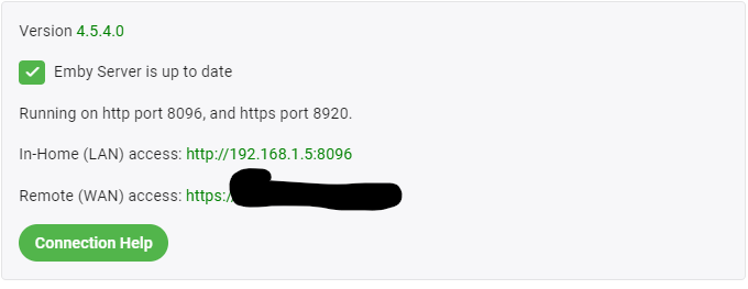

ebr 16334 Posted May 6, 2021 Posted May 6, 2021 Hi. Also make sure the addresses shown on your Emby Server dashboard are correct.
frankmb 41 Posted May 6, 2021 Author Posted May 6, 2021 13 hours ago, speechles said: You might need to check the "devices" tab of your Emby server. You can safely delete all Roku devices you find there. They will recreate themselves the next time a user with that device connects. That should be all this is. Let us know if this does not solve the problem. Also, try using sign out once. If you have remember me turned on this will not really sign you out. With remember me turned on using sign out allows to enter a new server/user combination. Now after sign out (while on server select screen) press HOME on your Roku remote. Then restart the app again. That may fix it without having to recreate the device. I tried deleting the Devices and restarting the server (restarted the docker container) and this didn't work I also tried signing out from within the app as you suggested and it didn't work.
frankmb 41 Posted May 6, 2021 Author Posted May 6, 2021 3 hours ago, ebr said: Hi. Also make sure the addresses shown on your Emby Server dashboard are correct. My server runs in docker and the local ip is set to the correct one in Network Settings->Local IP address

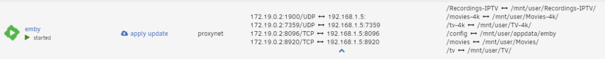

frankmb 41 Posted May 6, 2021 Author Posted May 6, 2021 embyserver-63755918458.txt I'm attaching the server log. The 4 "Udp message sent" at 17:17 are 4 times I tried launching the app on my roku tv and it failed to connect. What follows is me entering again the IP and password in the app and successfully logging into Emby. My port mapping are here too. I use Unraid. 1900 is not mapped because I didn't want DLNA working. those udp messages though... they might not be leaving the docker container?

Luke 42241 Posted May 12, 2021 Posted May 12, 2021 Generally I would suggest host networking mode for Docker. Thanks for the feedback.
ebr 16334 Posted May 13, 2021 Posted May 13, 2021 Did the LAN address on your dashboard change from what it was before as well?
frankmb 41 Posted May 13, 2021 Author Posted May 13, 2021 26 minutes ago, ebr said: Did the LAN address on your dashboard change from what it was before as well? What do you mean by "before"? I'm not sure I understand the question. Doing a System Restart on my roku tv fixed the problem. The LAN address on the dashboard uses the "Local IP address:" in Emby network settings. If that is not set, it becomes the docker IP address. I did a bunch of changes on my home network a few weeks ago and it is possible I had never restarted my roku tv since then.
ebr 16334 Posted May 13, 2021 Posted May 13, 2021 34 minutes ago, frankmb said: Doing a System Restart on my roku tv fixed the problem. Okay, so maybe that makes sense - not sure. The issue looked like the app was not able to save any information in its settings and I guess that operation fixed that. Thanks.
