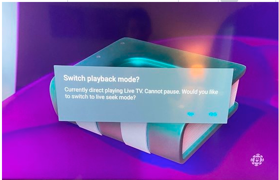

mike3821 67 Posted May 5, 2021 Author Posted May 5, 2021 (edited) I apologies guys, when I pick the switch playback mode it changes to direct streaming. this gives me the ability to pause and rewind. Is it not possible to have this on by default so this pop up doesn’t come up? Edited May 5, 2021 by mike3821
Carlo 4561 Posted May 5, 2021 Posted May 5, 2021 3 hours ago, Sammy said: It isn't transcoding; it's remuxing on the fly to direct stream. There's no quality loss but rather a repackage to h.264 from mpegts. Going from mpegts to h.264 would be the very definition of a transcode. 27 minutes ago, mike3821 said: I apologies guys, when I pick the switch playback mode it changes to direct streaming. this gives me the ability to pause and rewind. Is it not possible to have this on by default so this pop up doesn’t come up? Have you explored SETTINGS->LIVE TV menu in the app?
mike3821 67 Posted May 5, 2021 Author Posted May 5, 2021 2 minutes ago, cayars said: Have you explored SETTINGS->LIVE TV menu in the app? I have, and the only option I recall is telling it to direct play. It's either a check mark or not a check mark.
ebr 16338 Posted May 5, 2021 Posted May 5, 2021 24 minutes ago, mike3821 said: I have, and the only option I recall is telling it to direct play. It's either a check mark or not a check mark. Correct. Turn that option off if you want it to remux (for seeking). 1
mike3821 67 Posted May 5, 2021 Author Posted May 5, 2021 1 hour ago, ebr said: 2 hours ago, mike3821 said: Correct. Turn that option off if you want it to remux (for seeking). Okay thanks, I guess I have to decide if I want slower tuning or not.
ebr 16338 Posted May 5, 2021 Posted May 5, 2021 It depends on your normal usage. My advice would be to leave the direct play on and only engage the seek mode when you really need it - unless you are in the habit of always pausing your live TV. In that case, I would leave it off. 1
