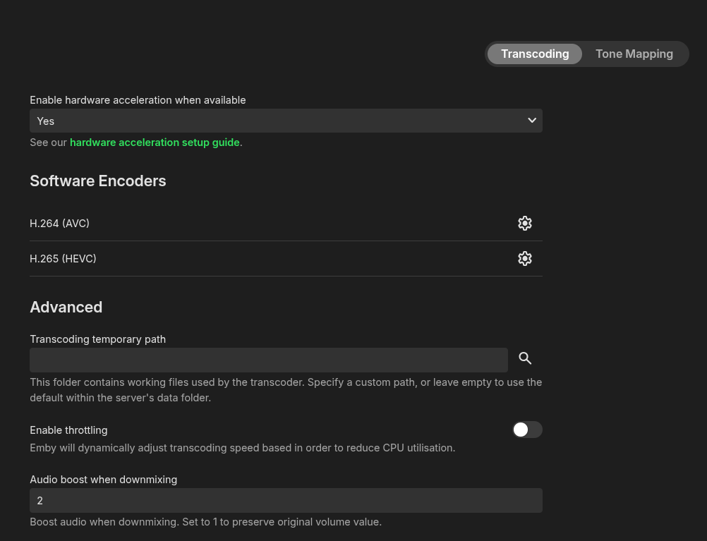

Q-Droid 1011 Posted February 8 Posted February 8 Your compose looks okay, HW detection and ffmpeg logs could show specific problems. But I see that you have another thread to troubleshoot the playback issues so you might as well continue over there since it doesn't appear to be a problem specific to Docker. One thing though - the transcoding temp path is going to default to your /config volume. So the type and size of storage used for /mnt/docker/emby can affect transcoding. In fact it can affect all of Emby.
Betonhaus 18 Posted February 8 Posted February 8 3 hours ago, Q-Droid said: Your compose looks okay, HW detection and ffmpeg logs could show specific problems. But I see that you have another thread to troubleshoot the playback issues so you might as well continue over there since it doesn't appear to be a problem specific to Docker. One thing though - the transcoding temp path is going to default to your /config volume. So the type and size of storage used for /mnt/docker/emby can affect transcoding. In fact it can affect all of Emby. I have my docker config folders on a m.2 nvme ssd. though I'm trying to troubleshoot if the transcoding issues is some sort of docker quirk so I'm setting up a baremetal install and set transcoding to /dev/shm
Q-Droid 1011 Posted February 8 Posted February 8 22 minutes ago, Betonhaus said: I have my docker config folders on a m.2 nvme ssd. though I'm trying to troubleshoot if the transcoding issues is some sort of docker quirk so I'm setting up a baremetal install and set transcoding to /dev/shm Having those on NVMe is pretty much ideal. The only limiter I can think of would be size if the transcoding temp usage gets big enough. As long as the config and transcoding paths are not on network storage you should be fine. Using HDD for config works but the latency can be noticeable for metadata cache and DB requests, more so for bigger libraries.
