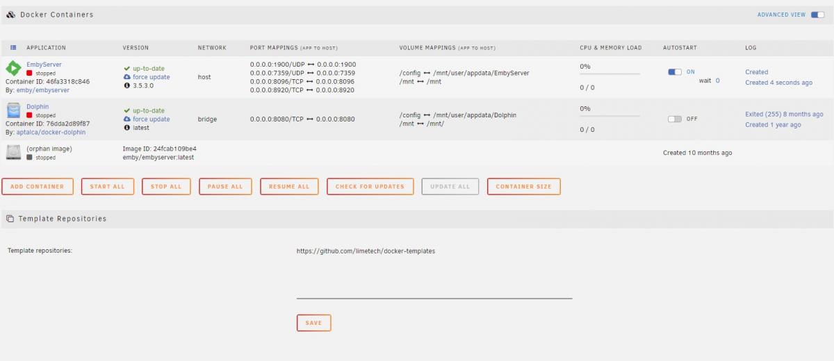

gnollo 17 Posted December 8, 2019 Posted December 8, 2019 I installed an emby docker on an unraid server, I need to update it. The message on the server management window is: "Version 3.5.3.0 A new version of Emby Server is available! Version 4.3.0.30 is now available for download. Please shutdown Emby Server and install the latest version." How do I install the latest version? And how do I backup the current installation so I can restore it if anything goes wrong? I posted the question on the unraid docker forum page but I am getting no response. Sent from my SM-A520F using Tapatalk
Luke 42243 Posted December 8, 2019 Author Posted December 8, 2019 I installed an emby docker on an unraid server, I need to update it. The message on the server management window is: "Version 3.5.3.0 A new version of Emby Server is available! Version 4.3.0.30 is now available for download. Please shutdown Emby Server and install the latest version." How do I install the latest version? And how do I backup the current installation so I can restore it if anything goes wrong? I posted the question on the unraid docker forum page but I am getting no response. Sent from my SM-A520F using Tapatalk Coming all the way from 3.5 you may not have a perfect upgrade. You'll likely need to run a full scan afterwards to restore library content. The top of the server log file displays the program data path. I would suggest taking a full backup of that.
gnollo 17 Posted December 8, 2019 Posted December 8, 2019 (edited) Coming all the way from 3.5 you may not have a perfect upgrade. You'll likely need to run a full scan afterwards to restore library content. The top of the server log file displays the program data path. I would suggest taking a full backup of that. Full backup = copy of the whole directory? Sent from my SM-A520F using Tapatalk Edited December 8, 2019 by gnollo
apefray 4 Posted December 9, 2019 Posted December 9, 2019 I installed an emby docker on an unraid server, I need to update it. The message on the server management window is: "Version 3.5.3.0 A new version of Emby Server is available! Version 4.3.0.30 is now available for download. Please shutdown Emby Server and install the latest version." How do I install the latest version? And how do I backup the current installation so I can restore it if anything goes wrong? I posted the question on the unraid docker forum page but I am getting no response. Sent from my SM-A520F using Tapatalk If it hasn't already been answered then, to update emby in unraid, goto the docker tab in unraid, click on emby and a menu will appear. Click on stop to stop the emby docker, and to the right of the emby icon is a bit of text that says apply update. Click this button and emby will be updated to the latest version. After the update has completed, click on done in the box that is shown, then click on the emby icon again, and restart emby. It may take a little longer to start than you are used to as it will upgrade several important parts, but after a while you should be able to gain access to emby's backend and frontend. Of course, as other have mentioned, its worth doing the backup first and as Luke has pointed out, make sure you do a full scan after the upgrade.
gnollo 17 Posted December 9, 2019 Posted December 9, 2019 If it hasn't already been answered then, to update emby in unraid, goto the docker tab in unraid, click on emby and a menu will appear. Click on stop to stop the emby docker, and to the right of the emby icon is a bit of text that says apply update. Click this button and emby will be updated to the latest version. After the update has completed, click on done in the box that is shown, then click on the emby icon again, and restart emby. It may take a little longer to start than you are used to as it will upgrade several important parts, but after a while you should be able to gain access to emby's backend and frontend. Of course, as other have mentioned, its worth doing the backup first and as Luke has pointed out, make sure you do a full scan after the upgrade. Thank you, that is what I did last time I upgraded and it messed up the system, the emby server would not start. That's why I want to make sure that if the upgrade does not work I can just copy the folder that I backed up over the upgraded install and get back my setup. Last time I had to delete the folder, install from scratch, then backup users and history. I had to recreate the settings as when I backed up the settings using the backup plugin, the server would not start again. Does it make any difference that I am have installed it via the apps repository on unraid?
apefray 4 Posted December 9, 2019 Posted December 9, 2019 (edited) Did you install the official emby Docker or the binhex/linuxserver verions??? The one I use, and have never had a problem with upgrades is the official version from the apps repository. I have been running emby for over 2 years, but the difference it seems is that I upgrade as a new version comes out, whereas you are a couple behind with the upgrades. I honestly don't know the answer to backing up and restoring as I have never had to revert to this, although I do an automatic backup through the emby server configuration backup of the last 5 days plus I also backup the whole emby server folder once a week. Edited December 9, 2019 by apefray
gnollo 17 Posted December 9, 2019 Posted December 9, 2019 Did you install the official emby Docker or the binhex/linuxserver verions??? The one I use, and have never had a problem with upgrades is the official version from the apps repository. I have been running emby for over 2 years, but the difference it seems is that I upgrade as a new version comes out, whereas you are a couple behind with the upgrades. I honestly don't know the answer to backing up and restoring as I have never had to revert to this, although I do an automatic backup through the emby server configuration backup of the last 5 days plus I also backup the whole emby server folder once a week. It's not the binex one Sent from my SM-A520F using Tapatalk
gnollo 17 Posted December 10, 2019 Posted December 10, 2019 Did you install the official emby Docker or the binhex/linuxserver verions??? The one I use, and have never had a problem with upgrades is the official version from the apps repository. I have been running emby for over 2 years, but the difference it seems is that I upgrade as a new version comes out, whereas you are a couple behind with the upgrades. I honestly don't know the answer to backing up and restoring as I have never had to revert to this, although I do an automatic backup through the emby server configuration backup of the last 5 days plus I also backup the whole emby server folder once a week. Found some instruction here on how to back up manually as well https://github.com/MediaBrowser/Wiki/wiki/Backup

gnollo 17 Posted December 21, 2019 Posted December 21, 2019 (edited) If it hasn't already been answered then, to update emby in unraid, goto the docker tab in unraid, click on emby and a menu will appear. Click on stop to stop the emby docker, and to the right of the emby icon is a bit of text that says apply update. Click this button and emby will be updated to the latest version. After the update has completed, click on done in the box that is shown, then click on the emby icon again, and restart emby. It may take a little longer to start than you are used to as it will upgrade several important parts, but after a while you should be able to gain access to emby's backend and frontend. Of course, as other have mentioned, its worth doing the backup first and as Luke has pointed out, make sure you do a full scan after the upgrade. It only shows 3.5.3.0. I force update, it does not go above that. How do I trigger a full install of the latest version? When I click on it it shows the following repository: emby/embyserver:3.5.3.0 Edited December 21, 2019 by gnollo
