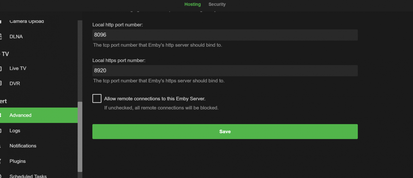

Haxy 11 Posted November 4, 2018 Posted November 4, 2018 How to enable https in docker container? Accessing 8920 port gets mi error
Luke 42243 Posted November 4, 2018 Author Posted November 4, 2018 Can you please describe your issue in more detail? Thanks.
Haxy 11 Posted November 4, 2018 Posted November 4, 2018 I am using this image: https://hub.docker.com/r/emby/embyserver/Accessing: https://Container_ip:8920 does not works " This site can’t be reached"
mediacowboy 438 Posted November 4, 2018 Posted November 4, 2018 (edited) I am using this image: https://hub.docker.com/r/emby/embyserver/ Accessing: https://Container_ip:8920 does not works " This site can’t be reached" So you have that port mapped for that container. Ports: - 8096:8096 - 8920:8920 Edited November 4, 2018 by mediacowboy
Haxy 11 Posted November 4, 2018 Posted November 4, 2018 So you have that port mapped for that container. Ports: - 8096:8096 - 8920:8920 Is that question? Yes I have
Luke 42243 Posted November 4, 2018 Author Posted November 4, 2018 Did you setup an ssl in emby server? You need to do that first under advanced. Thanks.
Haxy 11 Posted November 4, 2018 Posted November 4, 2018 I don't have any ssl settings under advancedtab
Luke 42243 Posted November 4, 2018 Author Posted November 4, 2018 Because you've disabled remote connections.
Haxy 11 Posted November 4, 2018 Posted November 4, 2018 So i cant use https because I dont need to use remote connections? Jesus...
Luke 42243 Posted November 4, 2018 Author Posted November 4, 2018 Why would you need https on just a local network?

Luke 42243 Posted November 4, 2018 Author Posted November 4, 2018 Try a different browser or incognito mode. I have the SSL settings under advanced in the Android app Most likely because you have the remote connections checkbox checked.
