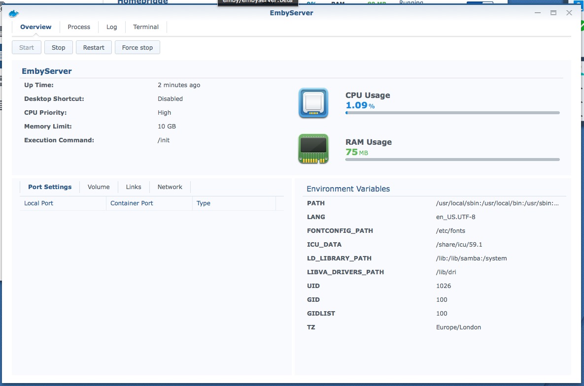

andyblac644 69 Posted April 8, 2018 Posted April 8, 2018 (edited) @@Luke how can we fix local date time, if TZDATA is not preinstalled ?, and the docker image does not adhere to the environment variable TZ= ??, can you get this fixed please, just atm all my timed stuff is 1hr out, due to BST. / # date Sun Apr 8 12:25:08 UTC 2018 / # echo $TZ Europe/London Edited April 8, 2018 by andyblac644

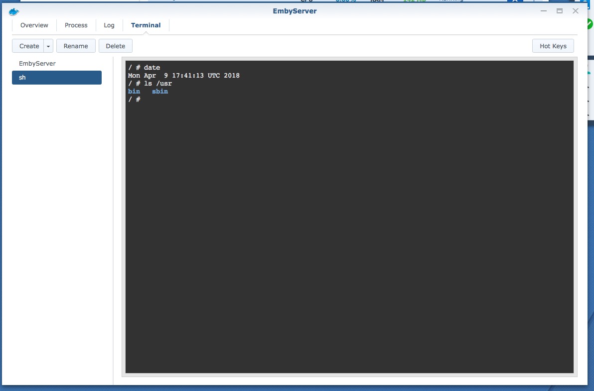

andyblac644 69 Posted April 8, 2018 Posted April 8, 2018 (edited) Tzdata has to be installed. That's the only way it's going to work. it's not, have a look for your self, files should be installed to /usr/share/zoneinfo/ / # ls /usr bin sbin / # https://packages.debian.org/sid/all/tzdata/filelist / # dpkg -i tzdata dpkg: can't open '/var/lib/dpkg/status': No such file or directory / # ls /var run spool www / # Edited April 8, 2018 by andyblac644

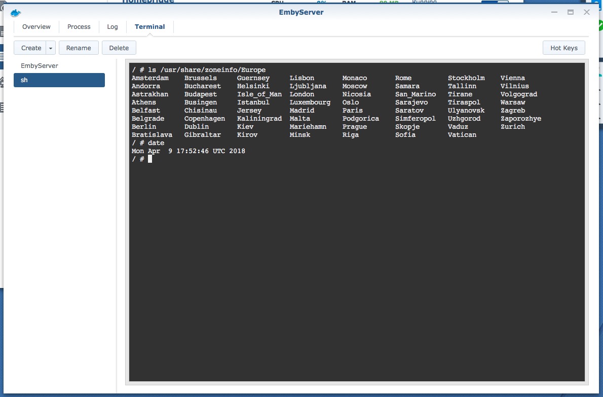

alucryd 318 Posted April 9, 2018 Posted April 9, 2018 (edited) @@andyblac644 Alright, can you try the latest beta? tzdata is now included, my logs show the correct time when the TZ variable is passed to the container. Edited April 9, 2018 by alucryd 1
andyblac644 69 Posted April 9, 2018 Posted April 9, 2018 (edited) @@andyblac644 Alright, can you try the latest beta? tzdata is now included, my logs show the correct time when the TZ variable is passed to the container. has it been pushed to beta ?, just I still only see UTC time, and no share folder in /usr ? Edited April 9, 2018 by andyblac644
alucryd 318 Posted April 9, 2018 Posted April 9, 2018 @@andyblac644 Apologies, I updated latest instead of beta, beta is rebuilding, should be up in a few minutes. 1
andyblac644 69 Posted April 9, 2018 Posted April 9, 2018 @@andyblac644 Apologies, I updated latest instead of beta, beta is rebuilding, should be up in a few minutes. ok tried what wrong, TZ= environmental set, and zone info is preinstalled but still on UTC
alucryd 318 Posted April 9, 2018 Posted April 9, 2018 Did you actually try launching emby? tzdata is a glibc thing, that date binary is from busybox, hence not built against glibc, it will happily ignore the TZ variable but emby won't. 1
andyblac644 69 Posted April 9, 2018 Posted April 9, 2018 Did you actually try launching emby? tzdata is a glibc thing, that date binary is from busybox, hence not built against glibc, it will happily ignore the TZ variable but emby won't. ah, no, let me try,
andyblac644 69 Posted April 9, 2018 Posted April 9, 2018 @@alucryd yup it seem date / time is now correct, nice one thanks a lot.
alucryd 318 Posted April 9, 2018 Posted April 9, 2018 No problem, glad it's working as expected now. 2

b0mb 36 Posted April 23, 2018 Posted April 23, 2018 @@alucryd yup it seem date / time is now correct, nice one thanks a lot. Whats that Scrreen from? 1
