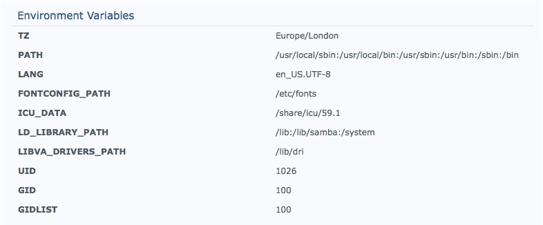

andyblac644 69 Posted April 5, 2018 Posted April 5, 2018 (edited) @@Luke could you add the setting to Emby docker to allow us to use the environment variable "TZ=Europe/London", because at the moment the emby dock is not using it. maybe it is due there is no zoneinfo ? Edited April 5, 2018 by andyblac644
andyblac644 69 Posted April 5, 2018 Posted April 5, 2018 (edited) Just add it when you set up the container. add what ? / # dpkg -i tzdata dpkg: can't open '/var/lib/dpkg/status': No such file or directory Edited April 5, 2018 by andyblac644
mastrmind11 722 Posted April 5, 2018 Posted April 5, 2018 (edited) The explicit command to use your environment timezone: -e TZ=<timezone> Edited April 5, 2018 by mastrmind11
andyblac644 69 Posted April 5, 2018 Posted April 5, 2018 (edited) The explicit command to use your environment timezone: -e TZ=<timezone> how if tzdata is not installed ?, and I as I said the environment variable is already set see above . Edited April 5, 2018 by andyblac644
