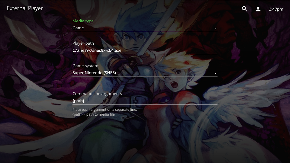

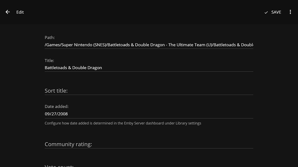

TrainAss 22 Posted July 31, 2016 Posted July 31, 2016 (edited) I've run in to an issue that has me stumped. I'm running Emby Server (dev) 3.1.6052.31460 via Docker. I have set up access to all my media folders (movies and TV Shows) plus my games. My media plays just fine, however when trying to play a game via emulator, Emby Theater (Windows 10) just spins. I have GameBrowser III setup correctly, the consoles show up properly and all the games are showing correctly too. Emby Docker has R/W access to all of its folders. I've also tried setting up the path substitution in the server console and pointed it to the actual shared folder and the results are the same. Emby Theater won't start the required emulator and game. Everything else is working flawlessly. The emulator that I've tried is zSNES and SNES9x (64bit) on Win10. Docker info Client:Version: 1.11.2API version: 1.23Go version: go1.5.4Git commit: b9f10c9Built: Wed Jun 1 21:36:47 2016OS/Arch: linux/amd64 Server:Version: 1.11.2API version: 1.23Go version: go1.5.4Git commit: b9f10c9Built: Wed Jun 1 21:36:47 2016OS/Arch: linux/amd64 The server logs and some screenshots are all attached. server-63605520000.txt Edited July 31, 2016 by TrainAss
