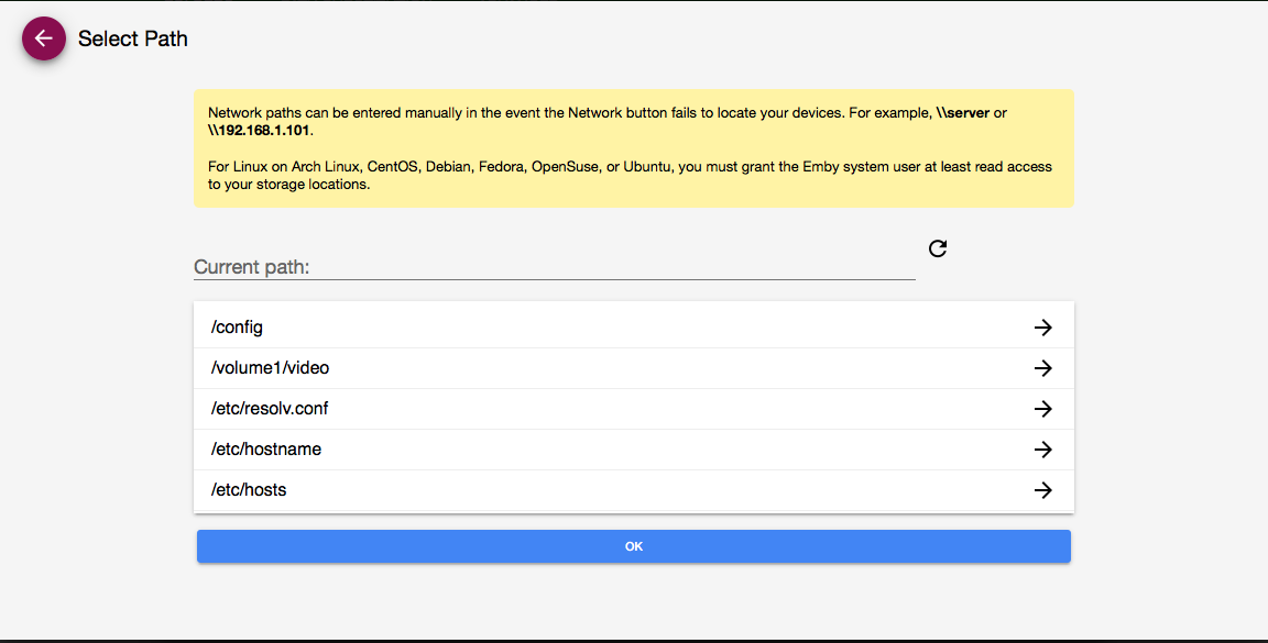

tariqmirza 1 Posted May 3, 2016 Posted May 3, 2016 (edited) I have the same issue whereas i install docker but when i try to locate the folder from within Emby, it seems it cannot locate. I have installed other docker e.g. sonarr and used the same method and gave permission to the folder which contains the media, but Emby comes up empty folder. If anyone can help that would be great. I attached couple of photos hope it helps. The media is storder inside /volume1 Edited May 3, 2016 by tariqmirza
tariqmirza 1 Posted May 3, 2016 Posted May 3, 2016 Managed to find the solution ...Yaay .. had to create a user "everyone" for the /volume1/video/ and afterwards the Emby was able to see the files inside there.. Attached picture hope it helps
