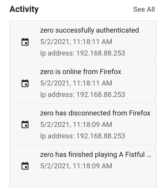

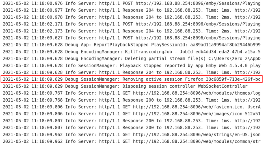

Learning_Curve 9 Posted May 2, 2021 Author Posted May 2, 2021 So, as an update: Re-enabling 3rd party cookies has no effect on this behavior. Interestingly, I managed to catch my being booted in the Activity segment of the Dashboard. (Pic attached.) Relevant lines from the log in 2nd image (Can't c&p from log for some reason).
