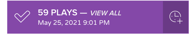

MaDTaZ 3 Posted June 5, 2021 Author Posted June 5, 2021 (edited) On 6/3/2021 at 9:46 AM, Luke said: hi @MaDTaZ thanks for the info ! Are you still having an issue with this? Hey Luke I am still am having the issue with it adding muiti view for no reason. It seems to be only when I choose watched on the whole series, Like I have the list and I just hold down and say watch and there is only one shows there. Last one I had an issue with is arctic vet and a time to kill I had a few that do it I have been going to trakt and remove them so that I dont get my api banned again. I am now on this version Here is the example that I just found when I went back to look at my history This one was added like 256 times May 25 was a bad day with it adding a crap ton. I have had to use this tool to remove duplicates since the beginning of May so they dont ban my api again https://huere.net/trakt/ I my logs only go back to 31 so I will see if I can see it again and then post my logs. Just ran the duplicate tool as well and it removed this Removed a total of 5250 play(s) from your history! I only watch a show once. Here is an example of what it does you will notice that I watched it way back in 2019 I have never watched that show again and then it tries to repost it 25 more times on 04-24-2021 I can guarantee I have never watched that show since 2019. Building Off the Grid (ID=94460) Season 1 1x3 North Pole (26 play(s)) 2019-11-11T04:16:46.000Z - ID=5073952205 - TYPE=watch 2021-04-24T16:58:52.000Z - ID=7525194442 - TYPE=watch 2021-04-24T16:58:52.000Z - ID=7525212505 - TYPE=watch 2021-04-24T16:58:52.000Z - ID=7525232235 - TYPE=watch 2021-04-24T16:58:52.000Z - ID=7525265218 - TYPE=watch 2021-04-24T16:58:52.000Z - ID=7525286411 - TYPE=watch 2021-04-24T16:58:52.000Z - ID=7525295614 - TYPE=watch 2021-04-24T16:58:52.000Z - ID=7525307929 - TYPE=watch 2021-04-24T16:58:52.000Z - ID=7525325055 - TYPE=watch 2021-04-24T16:58:52.000Z - ID=7525337098 - TYPE=watch 2021-04-24T16:58:52.000Z - ID=7525359467 - TYPE=watch 2021-04-24T16:58:52.000Z - ID=7525371560 - TYPE=watch 2021-04-24T16:58:52.000Z - ID=7525382382 - TYPE=watch Edited June 5, 2021 by MaDTaZ

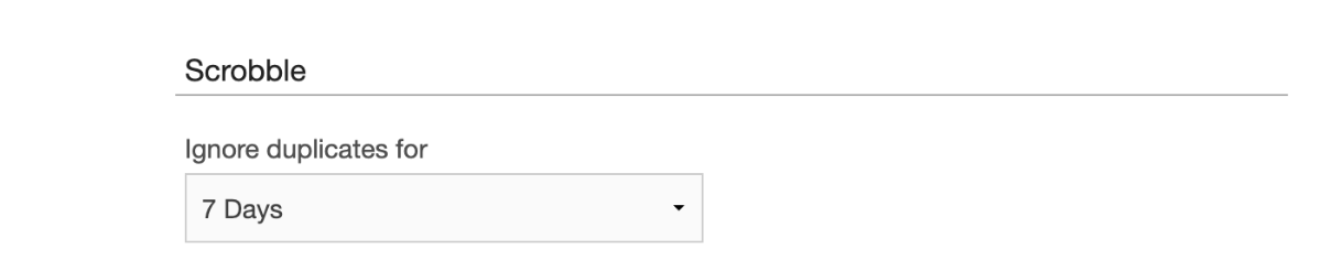

MaDTaZ 3 Posted June 21, 2021 Author Posted June 21, 2021 1 minute ago, Luke said: It looks like you've created automated schedules for the trakt scheduled tasks in emby server. This might be your problem. Those tasks are intended to be run once when you first install, and occasionally as needed after that to do a full re-sync, if for some reason you need to do that. They are not intended to be run on a regular basis. I have it set like that so that my play status will update plex as well and my libaray will be up to date. I will disable those for emby and see what happens. With the other plugin I use they have the option to disallow duplicates for that day or longer so that maybe something that I thought emby would do as well,
