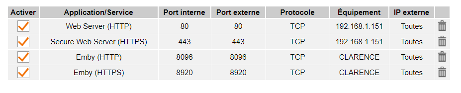

castoraman 0 Posted April 27, 2021 Author Posted April 27, 2021 30 minutes ago, rbjtech said: How are you connecting remotely ? from a web browser it should be http:\\<your WAN IP>:8096 Yes that's what I'm doing. Here is my NAT cfg : CLARENCE is my pc, 192.168.1.31 In UPNP cfg, Plex is showing up but not Emby.
rbjtech 5337 Posted April 27, 2021 Posted April 27, 2021 ok - that looks reasonable - So Assuming emby is running on your PC (Clarence) - I would use it's IP rather than it's name - ie 192.168.1.31 If emby is not running on this PC - then you need to put the IP where it is running. Other things to check are 1) Windows firewall has a suitable rule to allow incoming traffic (should be setup automatically when you install emby - but worth checking) 2) Security software (Anti-Virus etc) is not blocking the communication. For a short period, it's worth disabling the above just to check, if it then works, you know where to look next but don't forget to turn it back on ps - unrelated, but forwarding port 80 from the internet to any local server really is not recommended..

castoraman 0 Posted April 28, 2021 Author Posted April 28, 2021 18 hours ago, rbjtech said: 1) Windows firewall has a suitable rule to allow incoming traffic (should be setup automatically when you install emby - but worth checking) 2) Security software (Anti-Virus etc) is not blocking the communication. Tried to shutdown windows firewall, it's the same. I have no other fw software. 18 hours ago, rbjtech said: ps - unrelated, but forwarding port 80 from the internet to any local server really is not recommended.. Ok I removed this rule, dunno what it is since there is nothing under that IP on my network. 16 hours ago, cayars said: Take a look at this and tell us after the first line if any of the next 4 lines have an IP that starts with 10, 192, or 172? 80, 193, 193 and 193. 16 hours ago, cayars said: If not in a web browser on any computer on your LAN go to www.canyouseeme.org and run a test to port 8096 and 8920. 8096 pass, 8920 fails 16 hours ago, cayars said: Is the IP it shows on canyouseeme.org the same IP as shown in Emby Dashboard for your Remote IP? yes 16 hours ago, cayars said: Make sure you have no VPN services running on the server or client machines. No nothing like that. I tried the remote access via my mobile phone, without wifi so with the carrier network, and it's working. Very strange.
rbjtech 5337 Posted April 28, 2021 Posted April 28, 2021 Yes - the fact 8096 is responding is good - it means your port forward is working and emby is responding. The other good news is you do not have CGNAT. To note - You cannot test an external emby connection internally - unless you have setup some loopback networking. As you have found out - the best way to test is from a 3G/4G/5G phone with wifi turned off - ie a real WAN internet connection provided by your mobile. Enjoy ps - 8920 will only respond if you have setup HTTPS. 1
