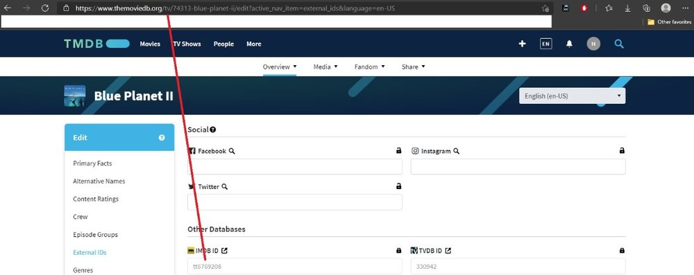

Happy2Play 9814 Posted April 27, 2021 Posted April 27, 2021 Another example showing the type from TMDB, requiring TV content type query to get info from them.
