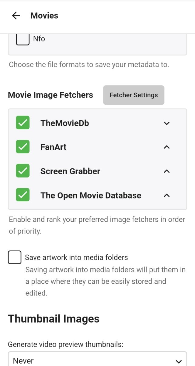

Edrock200 53 Posted April 25, 2021 Author Posted April 25, 2021 Sure, if I go to settings/library, click the 3 dots on each library then edit, then untick "save artwork into media folders."

Luke 42203 Posted April 25, 2021 Posted April 25, 2021 Can you show a screenshot of the settings for the library in emby library setup?
Luke 42203 Posted April 25, 2021 Posted April 25, 2021 How many emby libraries have you created? did you check the settings for each library?
Edrock200 53 Posted April 25, 2021 Author Posted April 25, 2021 Yes I checked setting in each library, but that poster generated above was from library setting screen shot I sent you
