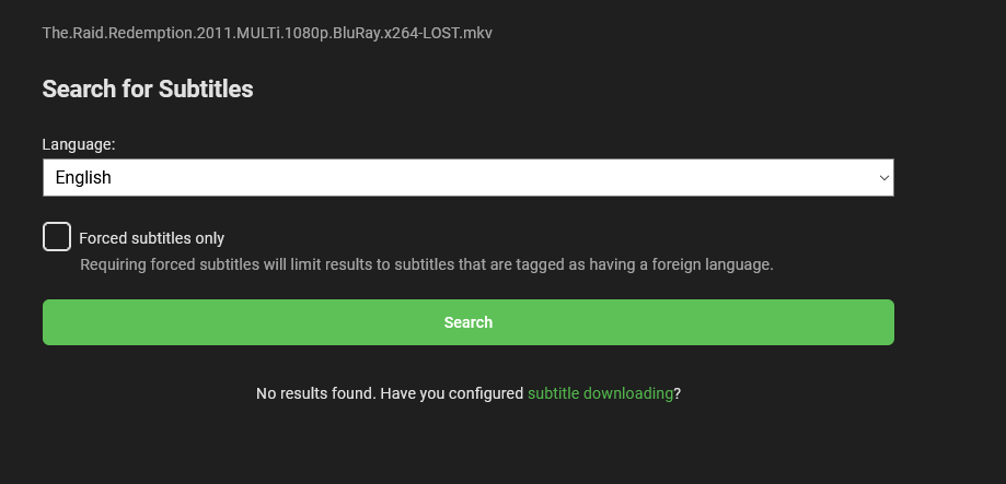

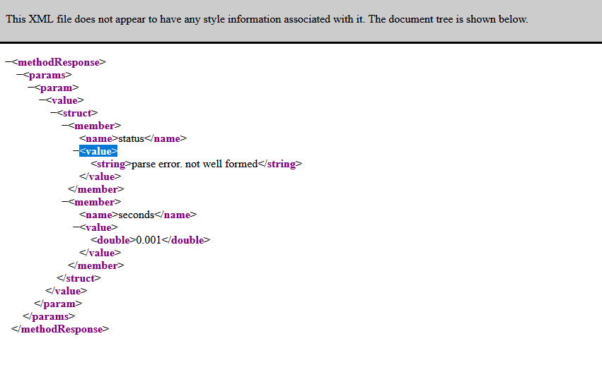

access 11 Posted April 25, 2021 Posted April 25, 2021 (edited) Hello, I've been trying to get OpenSubtitles working for a while, but can't seem to get it to work. Emby seems able to download images and update the tvdb database easily but when using the OpenSubtitle plugin and doing a manually search I get in the logs. I'm running a 64bit Synology system with Emby version 4.5.4.0. I can see it's getting a Error getting response from https://api.opensubtitles.org/xml-rpc System.Net.Http.HttpRequestException: System.Net.Http.HttpRequestException: No route to host 2021-04-25 13:10:18.882 Info HttpClient: POST https://api.opensubtitles.org/xml-rpc 2021-04-25 13:10:18.924 Error HttpClient: Error getting response from https://api.opensubtitles.org/xml-rpc *** Error Report *** Version: 4.5.4.0 Command line: /volume4/@appstore/EmbyServer/system/EmbyServer.dll -programdata /volume4/Emby -ffdetect /var/packages/EmbyServer/target/bin/ffdetect -ffmpeg /var/packages/EmbyServer/target/bin/ffmpeg -ffprobe /var/packages/EmbyServer/target/bin/ffprobe -nolocalportconfig -ignore_vaapi_enabled_flag -updatepackage emby-server-synology_{version}_x86_64.spk Operating system: Linux version 3.10.105 (root@build3) (gcc version 4.9.3 20150311 (prerelease) (crosstool-NG 1.20.0) ) #25556 SMP Thu Mar 18 12:58:52 CST 2021 Framework: .NET Core 3.1.8 OS/Process: x64/x64 Runtime: volume4/@appstore/EmbyServer/system/System.Private.CoreLib.dll Processor count: 8 Data path: /volume4/Emby Application path: /volume4/@appstore/EmbyServer/system System.Net.Http.HttpRequestException: System.Net.Http.HttpRequestException: No route to host ---> System.Net.Sockets.SocketException (113): No route to host at System.Net.Http.ConnectHelper.ConnectAsync(String host, Int32 port, CancellationToken cancellationToken) --- End of inner exception stack trace --- at System.Net.Http.ConnectHelper.ConnectAsync(String host, Int32 port, CancellationToken cancellationToken) at System.Net.Http.HttpConnectionPool.ConnectAsync(HttpRequestMessage request, Boolean allowHttp2, CancellationToken cancellationToken) at System.Net.Http.HttpConnectionPool.CreateHttp11ConnectionAsync(HttpRequestMessage request, CancellationToken cancellationToken) at System.Net.Http.HttpConnectionPool.GetHttpConnectionAsync(HttpRequestMessage request, CancellationToken cancellationToken) at System.Net.Http.HttpConnectionPool.SendWithRetryAsync(HttpRequestMessage request, Boolean doRequestAuth, CancellationToken cancellationToken) at System.Net.Http.RedirectHandler.SendAsync(HttpRequestMessage request, CancellationToken cancellationToken) at System.Net.Http.DiagnosticsHandler.SendAsync(HttpRequestMessage request, CancellationToken cancellationToken) at System.Net.Http.HttpClient.FinishSendAsyncUnbuffered(Task`1 sendTask, HttpRequestMessage request, CancellationTokenSource cts, Boolean disposeCts) at Emby.Server.Implementations.HttpClientManager.CoreHttpClientManager.SendAsyncInternal(HttpRequestOptions options, String httpMethod) Source: System.Net.Http TargetSite: Void MoveNext() InnerException: System.Net.Sockets.SocketException: No route to host Source: System.Private.CoreLib TargetSite: Void Throw() at System.Net.Http.ConnectHelper.ConnectAsync(String host, Int32 port, CancellationToken cancellationToken) 2021-04-25 13:10:18.925 Error SubtitleManager: Error downloading subtitles from Open Subtitles *** Error Report *** Version: 4.5.4.0 Command line: /volume4/@appstore/EmbyServer/system/EmbyServer.dll -programdata /volume4/Emby -ffdetect /var/packages/EmbyServer/target/bin/ffdetect -ffmpeg /var/packages/EmbyServer/target/bin/ffmpeg -ffprobe /var/packages/EmbyServer/target/bin/ffprobe -nolocalportconfig -ignore_vaapi_enabled_flag -updatepackage emby-server-synology_{version}_x86_64.spk Operating system: Linux version 3.10.105 (root@build3) (gcc version 4.9.3 20150311 (prerelease) (crosstool-NG 1.20.0) ) #25556 SMP Thu Mar 18 12:58:52 CST 2021 Framework: .NET Core 3.1.8 OS/Process: x64/x64 Runtime: volume4/@appstore/EmbyServer/system/System.Private.CoreLib.dll Processor count: 8 Data path: /volume4/Emby Application path: /volume4/@appstore/EmbyServer/system System.Net.Http.HttpRequestException: System.Net.Http.HttpRequestException: No route to host ---> System.Net.Sockets.SocketException (113): No route to host at System.Net.Http.ConnectHelper.ConnectAsync(String host, Int32 port, CancellationToken cancellationToken) --- End of inner exception stack trace --- at Emby.Server.Implementations.HttpClientManager.CoreHttpClientManager.SendAsyncInternal(HttpRequestOptions options, String httpMethod) at Emby.Server.Implementations.HttpClientManager.CoreHttpClientManager.SendAsync(HttpRequestOptions options, String httpMethod) at OpenSubtitles.OpenSubtitleDownloader.SendRequestAsync(ReadOnlyMemory`1 request, CancellationToken cancellationToken) at OpenSubtitles.OpenSubtitleDownloader.Login(CancellationToken cancellationToken) at OpenSubtitles.OpenSubtitleDownloader.Search(SubtitleSearchRequest request, CancellationToken cancellationToken) at MediaBrowser.Providers.Subtitles.SubtitleManager.<>c__DisplayClass17_0.<<SearchSubtitles>b__3>d.MoveNext() Source: System.Net.Http TargetSite: Void MoveNext() InnerException: System.Net.Sockets.SocketException: No route to host Source: System.Private.CoreLib TargetSite: Void Throw() at System.Net.Http.ConnectHelper.ConnectAsync(String host, Int32 port, CancellationToken cancellationToken) This error happens when I search for Subtitles Manually when it's playing. I can access the endpoint fine, and even logged into the linux terminal logged in as the Emby user and could hit that url. I can't work out why Emby can access all the other end points but fails on https://api.opensubtitles.org/xml-rpc. The version of Open Subtitle installed is 1.0.27.0 I can hit the endpoint fine in a browser. Thanks, if anyone has any guesses. Edited April 25, 2021 by access
rbjtech 5335 Posted April 25, 2021 Posted April 25, 2021 (edited) You have done a thorough investigation and eliminated all the obvious issues - so don't beat yourself up The error message is clearly point to a networking issue - but as proven by your tests, you can get to the URL just fine outside of emby/ the plugin. Looking at the actual DNS IP resolution of api.opensubtitles.org - 172.67.72.143 is one of the 3 IP's... Now, I know there has been some other topic on Emby classing any 172 address as 'local and not 'wan' (incorrectly, as the above IP is not an RFC1918 address). So I'm thinking - if you can add a local host entry for api.opensubtitles.org to resolve to either of the other IP's (104.26.8/9.126) then it may solve the immediate issue. If this does work - then the Dev team will need to look at this synology build, as it's classing 172.67.72.143 as local perhaps. It may be totally unrelated of course, but this is ringing alarm bells ... Edited April 25, 2021 by rbjtech 1

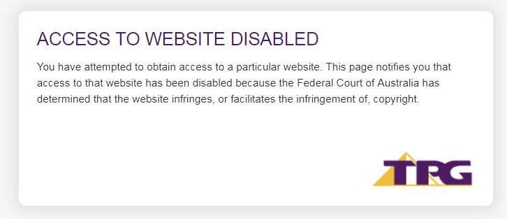

access 11 Posted April 25, 2021 Author Posted April 25, 2021 OMG Luke that's exactly it. Hilarious. https://www.zdnet.com/article/subtitle-piracy-will-it-be-enforced-in-australia/ The NIC the Synology server was running off didn't have the Google DNS configured, all my other machines in the house had the 8.8.8.8 as the DNS (as most Australians know to do!) Thanks!
