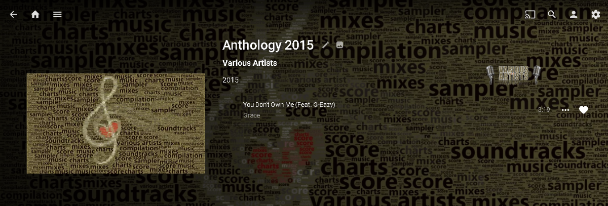

Eleumas31 18 Posted April 27, 2021 Author Posted April 27, 2021 (edited) @cayars @Happy2Play @Hxemby001 here we are! Metadata are all ok. Any idea why Emby don't display the ARTIST in some tracks? I installed 4.6 beta. Edited April 27, 2021 by Eleumas31

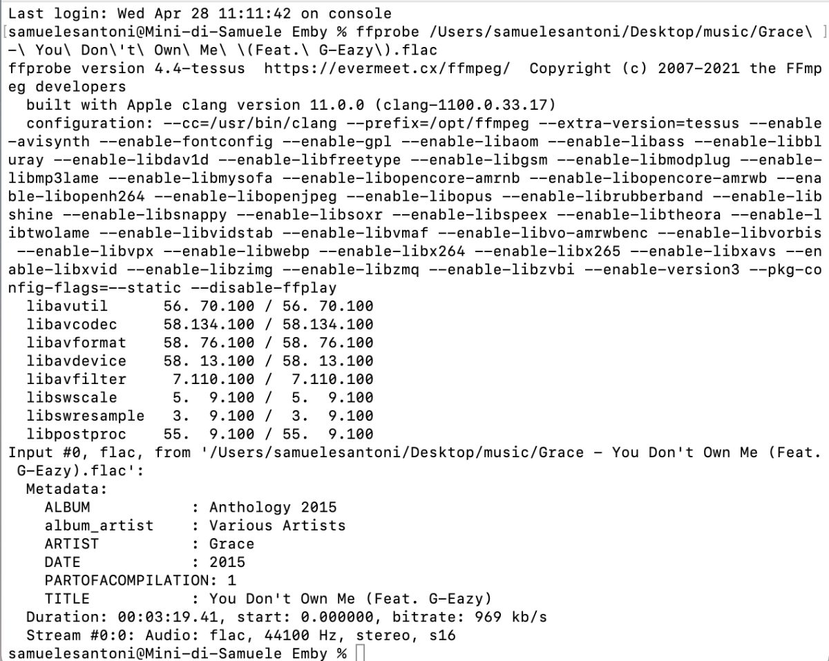

Eleumas31 18 Posted April 28, 2021 Author Posted April 28, 2021 (edited) How suggested by @Hxemby001 i downloaded Emby folder from NAS on my Mac. After i run the terminal from folder i have "tested" the song. This is the result: Edited April 28, 2021 by Eleumas31
Carlo 4561 Posted April 28, 2021 Posted April 28, 2021 Can you provide the album or track so we can test this internally with the ffprobe including with Emby? Looking at YOUR output GRACE is clearly picked up from the tag so it needs to be looked at and tested. Thanks

Eleumas31 18 Posted April 28, 2021 Author Posted April 28, 2021 (edited) @cayars what this means? If the file is ok and i have the 4.6 beta i should see the song in this way, instead i have a lot of songs without ARTIST in all album with multiple artists (compilation). If i move the song (for example Grace - you don't own me) in another album maybe the Artist appear. I moved a song (Willy Williams - Ego) from Anthology 2016 to Anthology 2015 and the artist (Willy Williams) it was been hidden. For some reason Emby in album with multiple artist has problem with metadata. How can i do an "hard reset" for Emby 4.6? Edited April 28, 2021 by Eleumas31

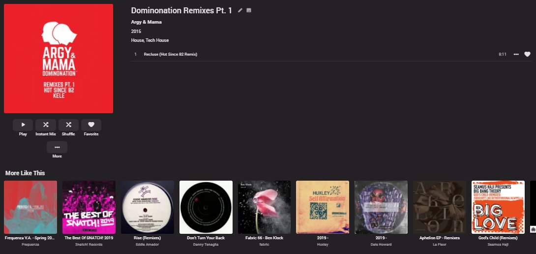

Guest Posted April 29, 2021 Posted April 29, 2021 (edited) I have ben having the same issue in the BETA version as well... The reason the '883' isn't showing artist though is because they are all by the same artist.. so that has been that way for as long as I remember. First example has DJ-KiCKS for the album artist, Terranova is the DJ/Mix Artist.. but also has tracks by them on the release.. Since the album artist does not match the Terranova name.. ( it is actually in the album name, which is not relative ) it shows them as artist as well. The second example of Argy & Mama shows when an album artist matches the artist name, exactly.. The third example shows the mix.. Eminem is the artist for the track on 1 and 9. EXAMPLE ONE EXAMPLE TWO EXAMPLE THREE Now what seems to be happening in your Anthologies.. and in some of my records, as well as artists.. is that it seems as though parts of the database have become corrupted or is locked from editing.. therefore EMBY is not able to update the information or write it. Multiple changes to the metadata and information from the file seems to trigger something. With it denying a save to the metadata entered into EMBY directly even. This is a guess.. Probably a question for @Luke or one of the Developers about what really is happening.. But at this point I think it can be established that there is an issue and it is not normal functionality. Edited April 29, 2021 by Guest
