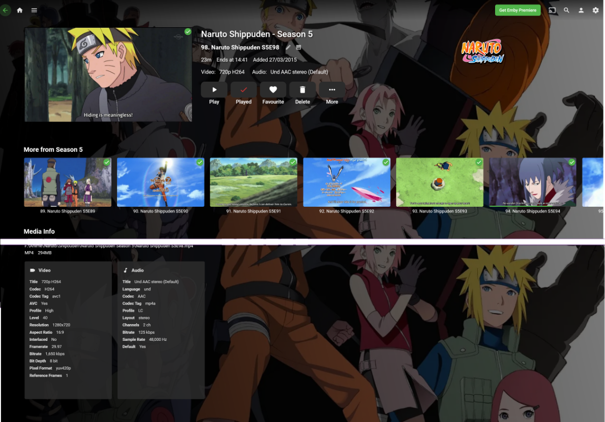

Carlo 4561 Posted April 26, 2021 Posted April 26, 2021 undefined auto type. Can you show us a picture of what the screen looks like in web right before you click the play button?
Zellogize 3 Posted April 26, 2021 Author Posted April 26, 2021 (edited) This part? Edit: ouch, reduced the quality when I took it in here Edited April 26, 2021 by Zellogize Added text
Carlo 4561 Posted April 26, 2021 Posted April 26, 2021 That looks fine. Would you be able to provide that file for testing purposes?
