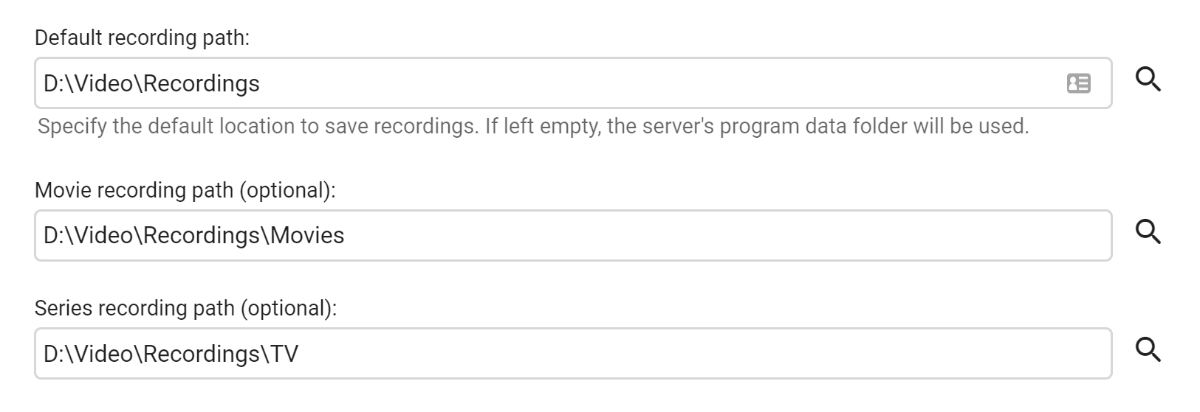

I have setup Emby to record some shows via the DVR function. I have it set with the optional paths and it correctly places the recorded TV series in the correct sub-folder. I have only setup TV series so far and they go into the TV sub-folder so I assume the Movies will also be placed correctly.

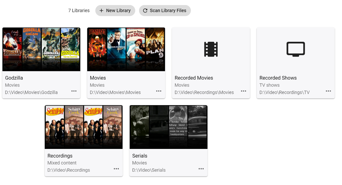

When I look at the Libraries, it shows the 3 libraries associated with the setup (Recordings, Recorded Movies and Recorded TV) and looks as if they are all pointing to the correct paths. As you can see, the 2 "Recorded" libraries seem to not show any backdrops as the Recordings and other libraries do.

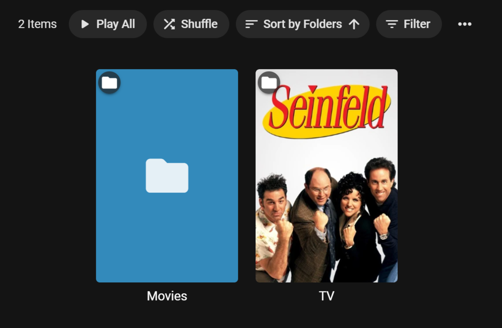

Recordings Library shows that TV has data. If I click on TV it displays all recorded Series correctly.

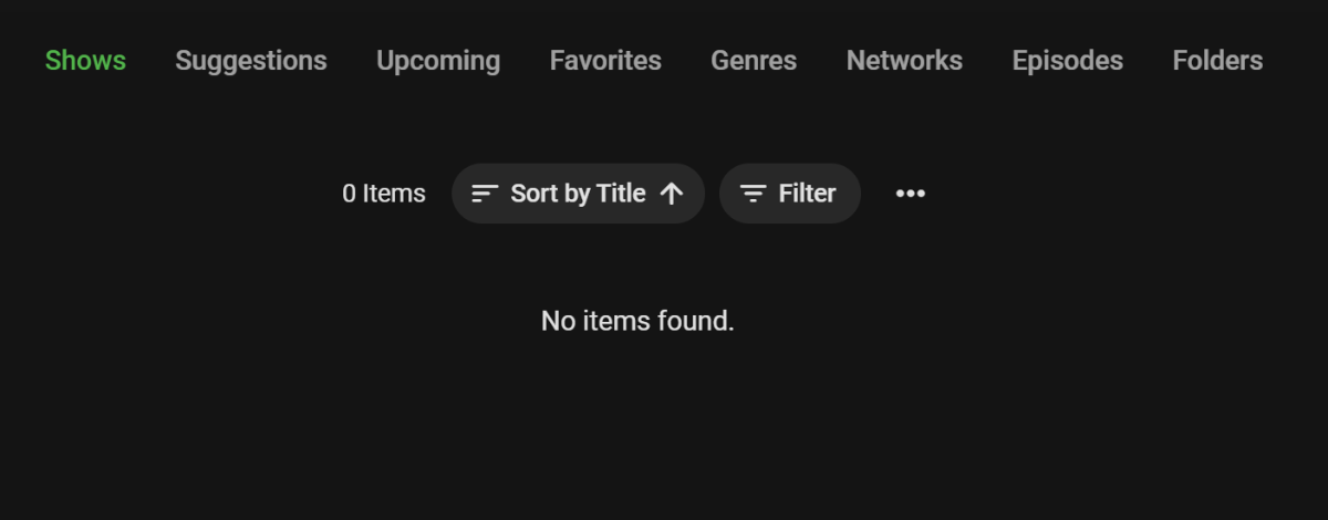

Clicking on either Recorded Movies or TV from My Media shows no items found.

Since you manually setup the movies and tv show library options, you can remove the default library.
Then try recording at least one movie.
How do things look after that?
Still the same after recording a couple of movies overnight. They all show up under the main Recordings library but the others are still empty. I tried creating a library that points to the TV folder and that also shows up as empty.

Changed the path options in DVR settings, then ran a Full Library scan and then removed excess Recording Libraries that were present.

You don't need the default storage path if setting the optional paths.
It would be a good idea to note that somewhere on the screen. currently the on screen text just talks about the default path being "optional"
Quote
Specify the default location to save recordings. If left empty, the server's program data folder will be used.
maybe a note below where the optional recording paths state that it set, please unset the "Default recording path"
Part of this is just speculation on my part, but I recommend removing it as I've seen less duplicate Recording Libraries created without it set.
