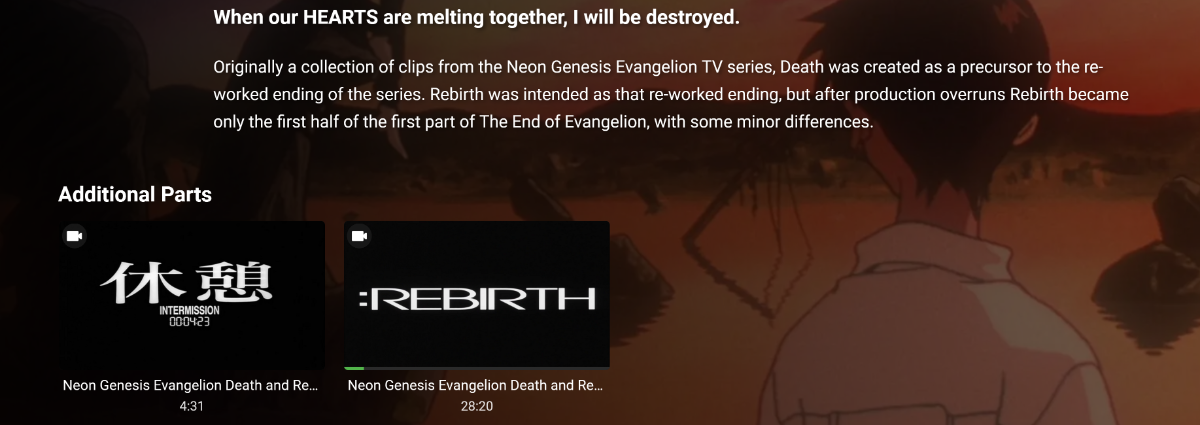

access 11 Posted April 22, 2021 Posted April 22, 2021 Hello! I have searched many topics regarding this and I can see and have read a lot of people having problems similar, I've read the solutions, but I just can't seemingly get it to work and it's been confusing me for a few months. I'm currently going through the arduous task of trying to classify Evangelion. Very difficult series to collect. My Anime Library is mixed media has two folders; * anime/movies/ * anime/tv-series/ I want to see the movies appear as "Additional Parts" like how this film appears as; My folder is; anime/movies/Neon Genesis Evangelion Death and Rebirth (1997)/Neon Genesis Evangelion Death and Rebirth (1997) [BR-Rip 8btis x264 1080p AAC][ENG] - CD1.mkv anime/movies/Neon Genesis Evangelion Death and Rebirth (1997)/Neon Genesis Evangelion Death and Rebirth (1997) [BR-Rip 8btis x264 1080p AAC][ENG] - CD2.mkv anime/movies/Neon Genesis Evangelion Death and Rebirth (1997)/Neon Genesis Evangelion Death and Rebirth (1997) [BR-Rip 8btis x264 1080p AAC][ENG] - CD3.mkv All three parts have the CD-1, CD-2, CD-3 suffix but Emby keeps seeing them as seperate films, and I wonder if it's because its in a Mixed Media. Can anyone suggest what I am doing wrong with the naming convention? Thanks all.

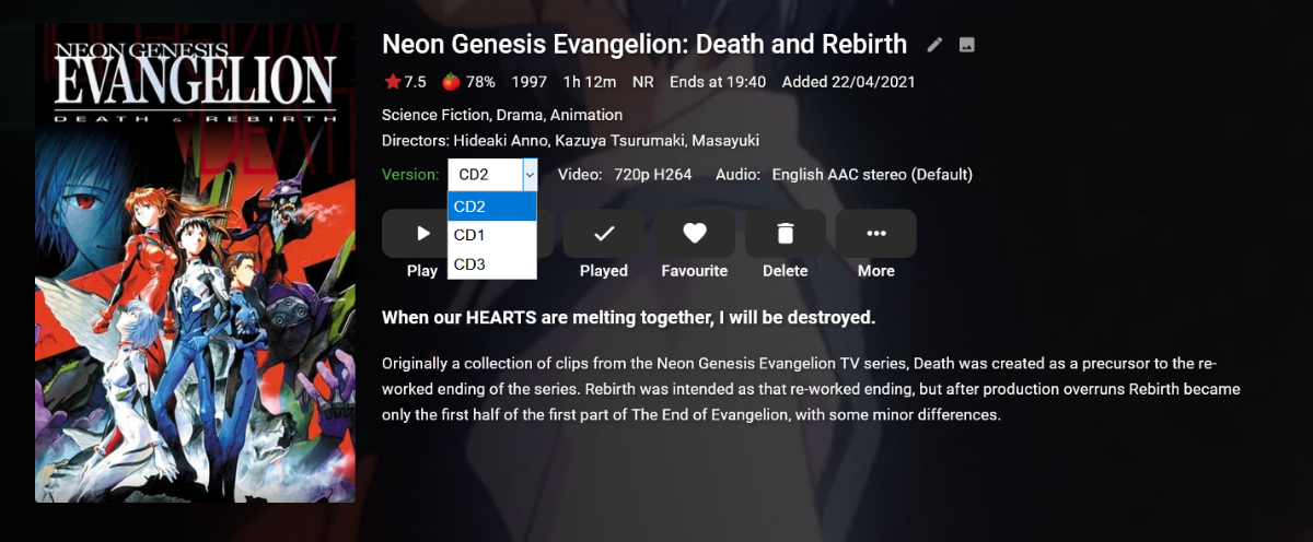

access 11 Posted April 22, 2021 Author Posted April 22, 2021 (edited) Thanks for responding pwhodges, I changed the names; Neon Genesis Evangelion Death and Rebirth (1997)/ Neon Genesis Evangelion Death and Rebirth (1997) - CD1.mkv Neon Genesis Evangelion Death and Rebirth (1997) - CD2.mkv Neon Genesis Evangelion Death and Rebirth (1997) - CD3.mkv This hasn't had the desired effect, it's caused them to be "Merged" as different versions. This hasn't produced the same effect as the "Additional Parts" as show above. Hmmm Edited April 22, 2021 by access

Solution access 11 Posted April 22, 2021 Author Solution Posted April 22, 2021 Thanks so much! I've been nervous about using anything but CD as thats all I've seen work but I did read the others worked as well. I tried using PART and removing the space and it did not solve my problem. I *have* solved my problem and I did not provide enough information here. I just noticed the middle part the "intermission" was a mp4 not an mkv. So the "Additional Parts" mechanism only seems to work when the media files are all of the same file type. Not sure that's really necessary but I converted the file to mkv and now it works beautifully! I'm not sure you understood how I wanted to store it, for Death and Rebirth, I wanted the three parts; Death Intermission Rebirth The allows the skip mechanism to work. I really like this approach for all the "Double Feature" media. Once again, thanks for your help!

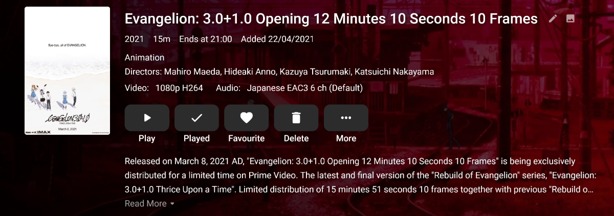

access 11 Posted April 22, 2021 Author Posted April 22, 2021 (edited) Hahaha, then you will be even more confused why I have things like the following for the previous Rebuilds. It's all mostly for academic reasons as it's good to track how things came out, in an attempt to capture something not possible to capture. Edited April 22, 2021 by access 1
