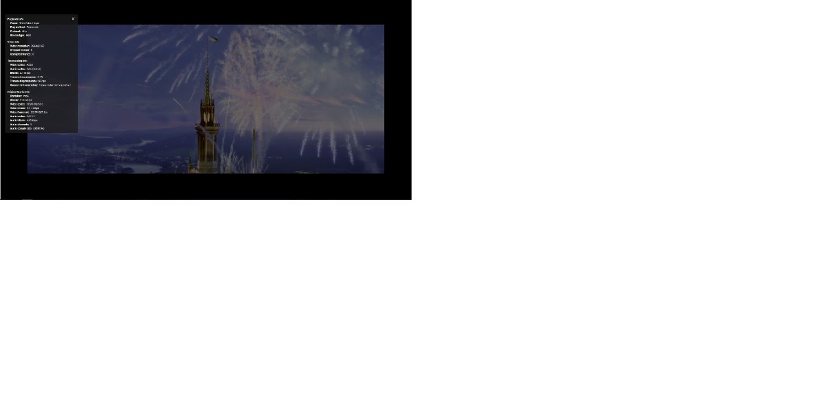

tmmedic20 1 Posted April 17, 2021 Author Posted April 17, 2021 42 minutes ago, cayars said: Well chrome can't do this as it will look washed out without tone mapping done on the server. But I don't see how chrome can transcode and playback but the fire tv transcode only runs about 1/2 speed. That makes no sense. As I stated I'm really new at this stuff (Meaning Media Servers) and have no clue what Im talking about for the most part but my server is: On the other had I do have some working knowledge on servers and hardware: My Setup a Dell Poweredge r710 Dual Intel Xeon E5649 @2.53Ghz 120 GB of DDR memory 12TB of storage using 2 TB 7200RPM HD and 2 4TB 7200 RPM HD Quad 1GB nics on a Bond0 configuration (Yes the switch is configured for the bond) I really need to add a Video card for transcoding but up till now it has served my purposes and this is the only time ive had an issue. If any of that mattters I'm am baffled that I can watch any of my library on a Samsung Tab A but FireStick has issues. Attacked pic showing the chrome browser and its "stats for nerds"
Carlo 4561 Posted April 17, 2021 Posted April 17, 2021 Can you try uploading that picture again but not 1/4 screen size? Can't read the stats for nerds screen. 1

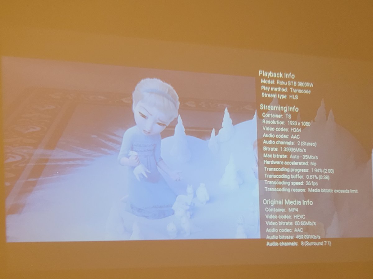

tmmedic20 1 Posted April 17, 2021 Author Posted April 17, 2021 Just now, cayars said: @tmmedic20 Can you check "Allow subtitle extraction on the fly" from transcoding menu and turn this off if enabled and test again? At work for the next 48 hours but will do soon as I get home. As well as reuploadong the full size stats. Here is a picture of the stats that I grabbed using a roku stick (sorry don't remeber the model number) on a projector which also played fine.
ebr 16338 Posted April 17, 2021 Posted April 17, 2021 Looks like no subs in play there... but it is a 60Mb HEVC file.
Carlo 4561 Posted April 17, 2021 Posted April 17, 2021 24 minutes ago, tmmedic20 said: Here is a picture of the stats that I grabbed using a roku stick (sorry don't remeber the model number) on a projector which also played fine. Thanks but we really need to see the Stats for Nerds from the Fire Stick. BTW, are these clients in your network or playing back remotely? I ask because that pic showed an exceeding bitrate message.
tmmedic20 1 Posted April 17, 2021 Author Posted April 17, 2021 7 minutes ago, cayars said: Thanks but we really need to see the Stats for Nerds from the Fire Stick. BTW, are these clients in your network or playing back remotely? I ask because that pic showed an exceeding bitrate message. They are on same network. (Roku may have been on a different Vlan I didn't check which SSID it connected to. Can't show you stats for nerds on the fire stick since it won't play the file.
ebr 16338 Posted April 17, 2021 Posted April 17, 2021 1 hour ago, cayars said: that pic showed an exceeding bitrate message 60Mb/s is way beyond the published specs for the Fire stick (about 25) so that would be the case for that file unless the setting in the app was changed off of "Auto". 1
