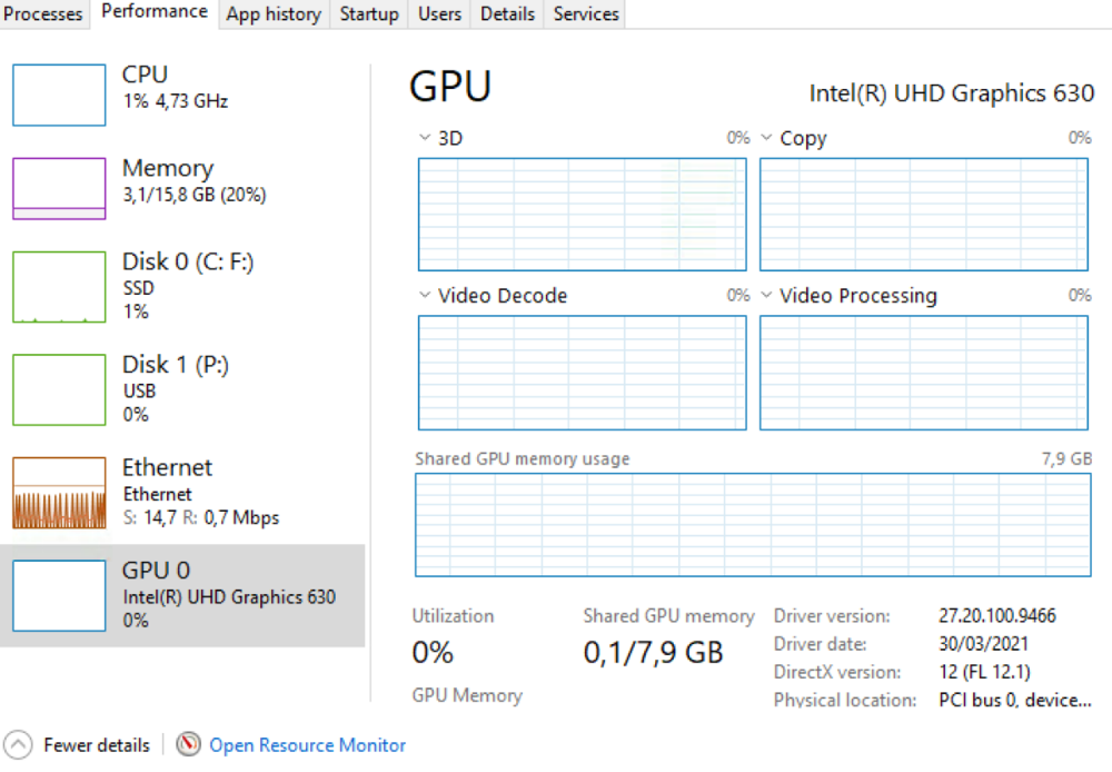

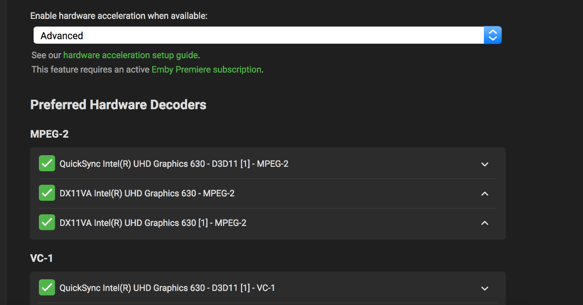

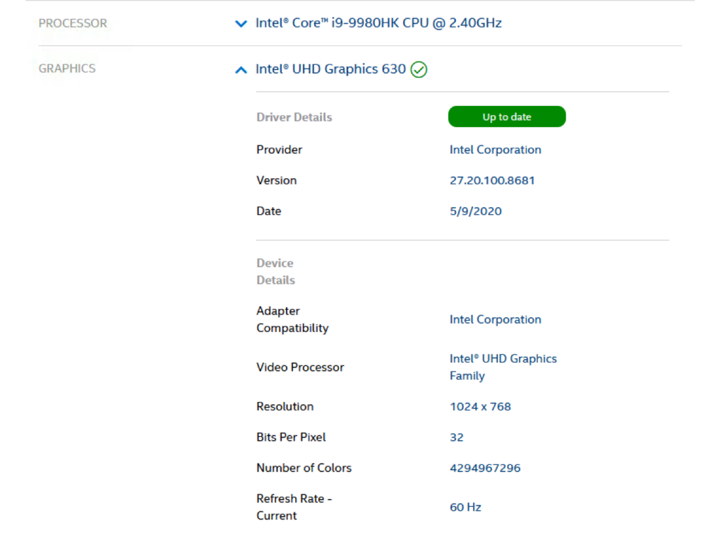

Painkiller88 250 Posted April 28, 2021 Author Posted April 28, 2021 Yes my drivers are the most actual for my cpu/igpu for the nuc i9 i downloaded them directly from the website and the drivers check from my nuc also tells me i am up to date. Here are the transcoding settings, i really took care to have the QuckSync option for every codec on the first position. As i am connected via RDP to my Emby Server the resolution in the drivers pic is not the full, but drivers are up to date.
Carlo 4561 Posted April 28, 2021 Posted April 28, 2021 (edited) Hi, 27.20.100.9466 is the latest drivers for the HD630 with a release date of 4/16/2021 or just 12 days ago. https://downloadcenter.intel.com/product/126790/Intel-UHD-Graphics-630 Edited April 28, 2021 by cayars
Painkiller88 250 Posted April 28, 2021 Author Posted April 28, 2021 ok strange the intel update assistant tells me i am acutal. maybe the DCH drivers are not checked if i have an OEM driver. Will install the DCH driver and have an eye on emby transcoding. Thanks

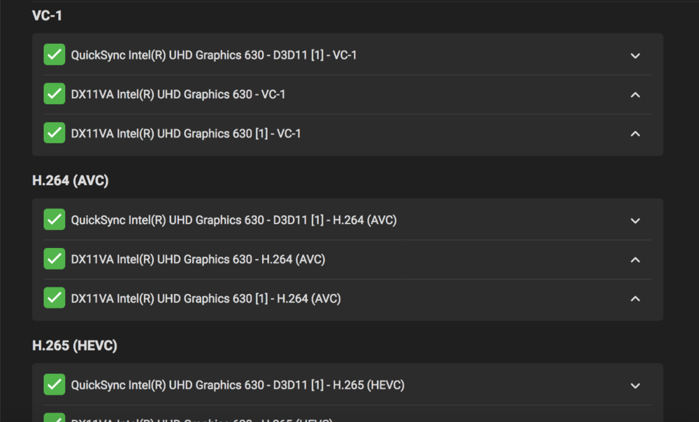

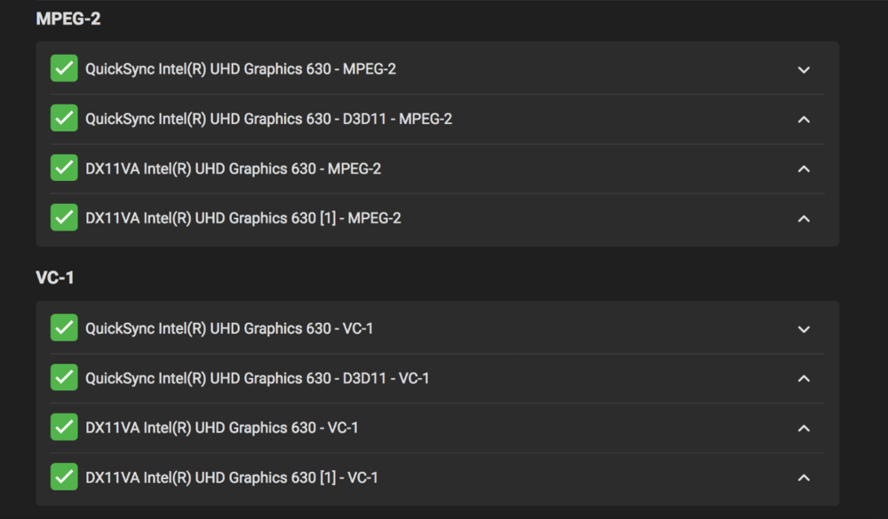

Painkiller88 250 Posted April 28, 2021 Author Posted April 28, 2021 Ok strange, after installing the new DCH driver i checked transcoding and saw i got a new entry for every codec. the new entry seems not to use D3D11, so i enabled it and put on the first place for all codecs

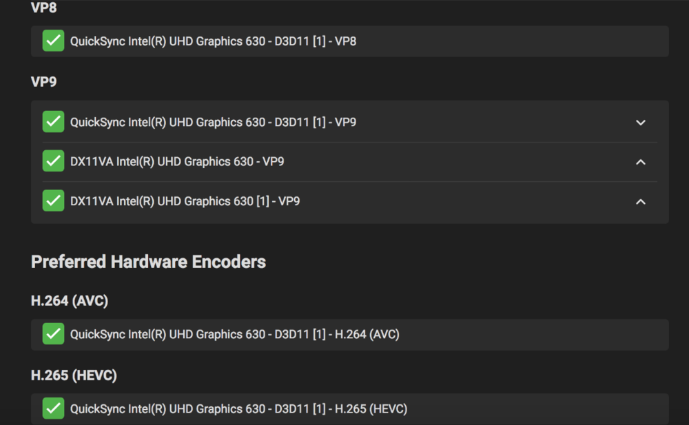

Painkiller88 250 Posted May 4, 2021 Author Posted May 4, 2021 Ok i think i am a step further. Just setting the Hardware Acceleration to ON, does not help. I set it to advanced and played around. Now it seems Disabling all Encoders/Decoders except the ones with D3D11 works till now. I started the same stream about 30 Times with different settings, and this seems to be a solution for now. I just wonder why, because i had the normal QuickSync without D3D11 on the first place till now, as i have DX12 and not DX11 installed on my System. i will investigate more time on this and see if it is a final solution
