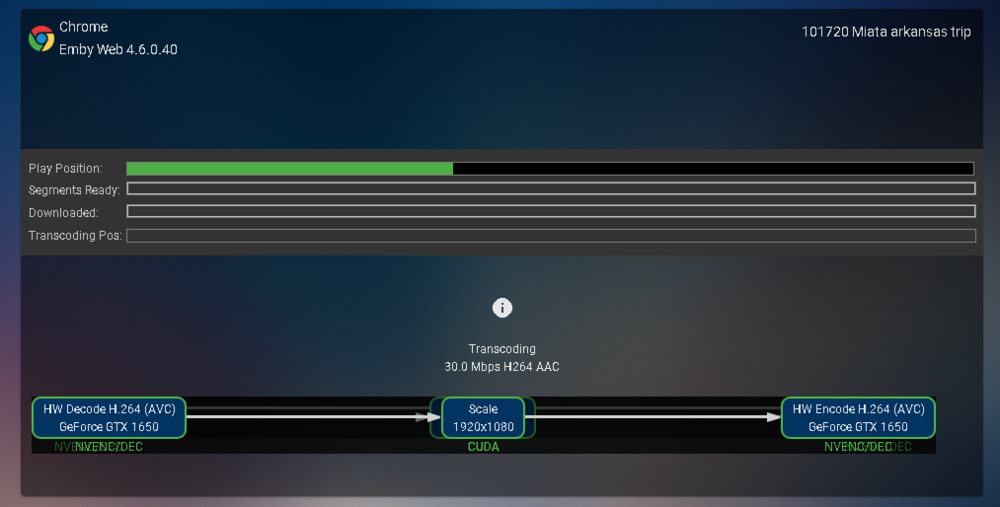

Carlo 4561 Posted April 26, 2021 Posted April 26, 2021 I'm sorry could have swore I posted but this is what I get So as you can see this does play back fine with hardware on my system with the GTX 1650.
Carlo 4561 Posted April 26, 2021 Posted April 26, 2021 So that's two of use with different GPUs not having an issue. Have you checked your drive space to make sure you have enough space available for the transcode file on the server?

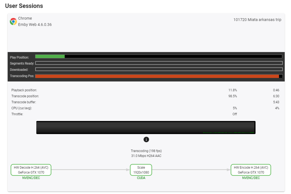

rbjtech 5337 Posted April 26, 2021 Posted April 26, 2021 Yep - I run the same CPU and GPU as you - with throttle turned off - the 1070 is transcoding the entire clip in ~ 46 seconds (you can see below).
