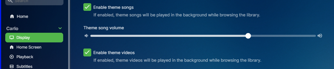

Carlo 4561 Posted February 17, 2025 Posted February 17, 2025 I was asked privately about displaying themes so I'll add this here in case anyone else might benefit from it. The use of themes can typically be turned on or off in Emby clients, so if not working as expected, make sure the client has the option(s) enabled. Example: Settings for the web client: @rekit Often times advanced features that use subdirectories expect the parent folder is used for a single movie/show/video so all metadata in the directory or subdirectories is for that one entity. You could have multi parts to a single movie or different versions of a specific movie in the same directory, but they are all related to the same movie. A 720, 1080 & 4K version of Top Gun (1986) could all be present in /Movies/Top Gun (1986) with a /backdrops folder that would work for Top Gun. You could not however have a /Movies/Tom Cruise folder that has both Top Gun and Days of Thunder in it with a backdrops folder as the relationship of backdrop to movie is not present. It's generally always best to have a single directory for each and every movie so everything in and below that directory is specific to the named directory. 1
