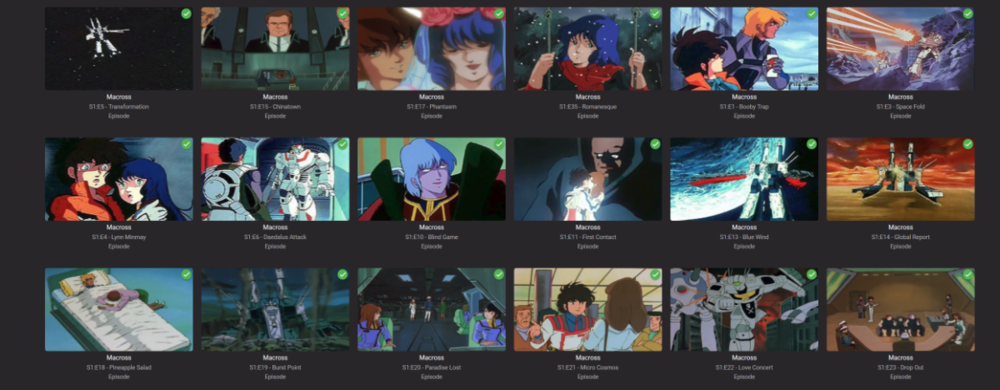

Episodes showing up when I search; but not in the actual Show. Only some of them.
Mkilbride
For example:
Shows as nothing here. It's empty. BUT, if I search?
Episodes show up.

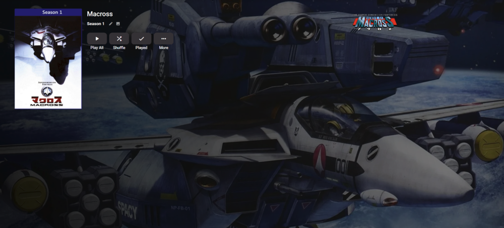

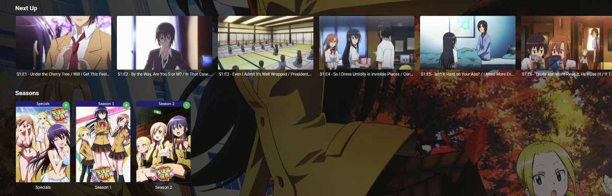

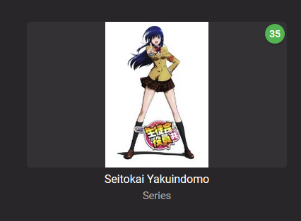

Another example:
35 episodes show.  But when I go inside it?

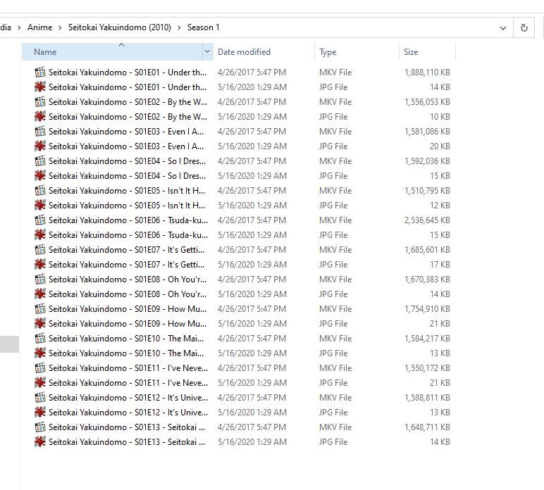

Only the Specials are showing up in the seasons. They are ALL labeled correctly.
Most shows are fine. I can't figure out why this happens.
