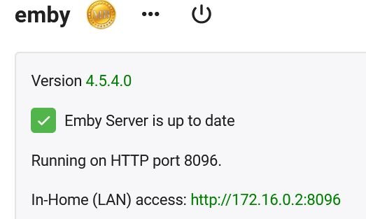

Flintfamily 6 Posted April 15, 2021 Author Posted April 15, 2021 The dashboard shows as above 172.16.0.2 but the actual Lan is 192.168.0.1. The setting in network tab for local IP is blank I.e. default.
Carlo 4561 Posted April 15, 2021 Posted April 15, 2021 Change that setting in Network menu to be 192.168.0.105 (based on what you said the IP was earlier). Restart your server. 192.168.0.1 is almost always your router IP not Emby Server. Does 192.168.0.105 show up as the IP in the dashboard now?
Flintfamily 6 Posted April 15, 2021 Author Posted April 15, 2021 I get only the port number not the full IP and port...
Flintfamily 6 Posted April 15, 2021 Author Posted April 15, 2021 And still getting the same error from the Gdrive plugin
