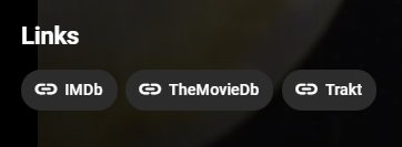

Solution Happy2Play 9802 Posted April 10, 2021 Solution Posted April 10, 2021 (edited) My guess is your providerids, Do all of your media item get this? <imdbid>-2</imdbid> <tmdbid>-2</tmdbid> So every item add will have the same ids, wrong ids. <id>-2</id> Not positive how much ID is used. I would assume all the Links if clicked on in Media are broken also. Or at least all items with wrong ids. Edited April 10, 2021 by Happy2Play
Omahabrownie 9 Posted April 10, 2021 Author Posted April 10, 2021 I checked the external Ids for a few and notice some that are marked wrong have a -2 for the number under both the IMDb id and The Moivedb id would this be what you are talking about?
Happy2Play 9802 Posted April 10, 2021 Posted April 10, 2021 1 minute ago, Omahabrownie said: I checked the external Ids for a few and notice some that are marked wrong have a -2 for the number under both the IMDb id and The Moivedb id would this be what you are talking about? Yes so to Emby this id makes all items the same item because they have the same id.
