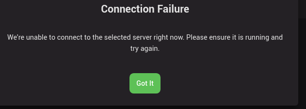

toolmanz 3 Posted April 5, 2021 Author Posted April 5, 2021 When I try to add the server it gives me this error: It is up and running .....
Carlo 4561 Posted April 5, 2021 Posted April 5, 2021 Hi, I would suggest taking a look at our Knowledge Base starting with https://support.emby.media/support/solutions/articles/44001159034-quick-start To add users (local & remote) follow this guide https://support.emby.media/support/solutions/articles/44001160237-users Before any users can connect remotely you have to set the server up to work remotely (doesn't out of the box) https://support.emby.media/support/solutions/articles/44002137137-remote-setup Let us know how you make out or what you need additional info on. Carlo

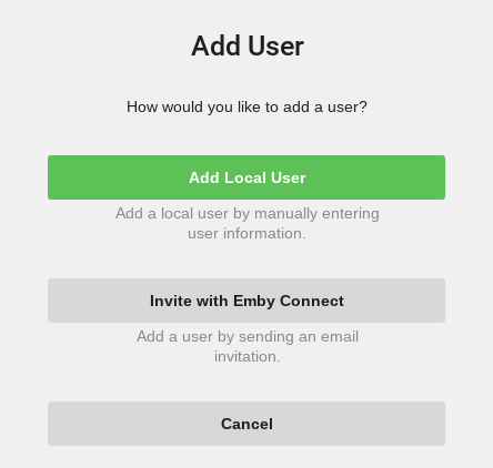

clarkss12 304 Posted April 6, 2021 Posted April 6, 2021 I am looking for the same answer. In the near future I will be adding a nephew so he can view his dad's home videos.......... I am looking for the option to send an invite via Email. I don't see that option........ Here is from your instructions.
Carlo 4561 Posted April 6, 2021 Posted April 6, 2021 Hi, I'm going to be editing that KB article shortly to change it a bit as it doesn't work exactly like that any more. But a couple of questions for you. Do you need to use Emby Connect? Do you have a domain name for your house/Emby Server? If so you don't need EC. Do you use a DDNS service which a lot of home routers can do by default if you setup an account? If so you can use that DDNS address in Emby. Either of the two methods mentioned above allows a user to enter a URL (name vs IP) into an app or browser and get to your Emby Server. If you don't have or don't want to do that then assuming you have setup Remote Access and tested it to work. https://support.emby.media/support/solutions/articles/44002137137-remote-setup So with remote access working but no "name" to IP translation (dns) you would want to use Emby Connect. In this case setup a local user on your network and then ask the user to go to http://app.emby.media/ and create an account. Then have them send you an email with their username which you can fill into to the optional Emby Connect username field. So if you will only have a user or two (or three) using you server Emby Connect might be easiest setup wise but if you have a half a dozen user or more you should setup your server with an actual DNS name and have users use this and login directly. Let me know what might not be clear about any of this. Carlo

clarkss12 304 Posted April 6, 2021 Posted April 6, 2021 (edited) what do I put into these boxes? I can have him install the Emby app, (not sure what device he has yet), then what do I do? So, I have him create an account? Then use his user name? Edited April 6, 2021 by clarkss12

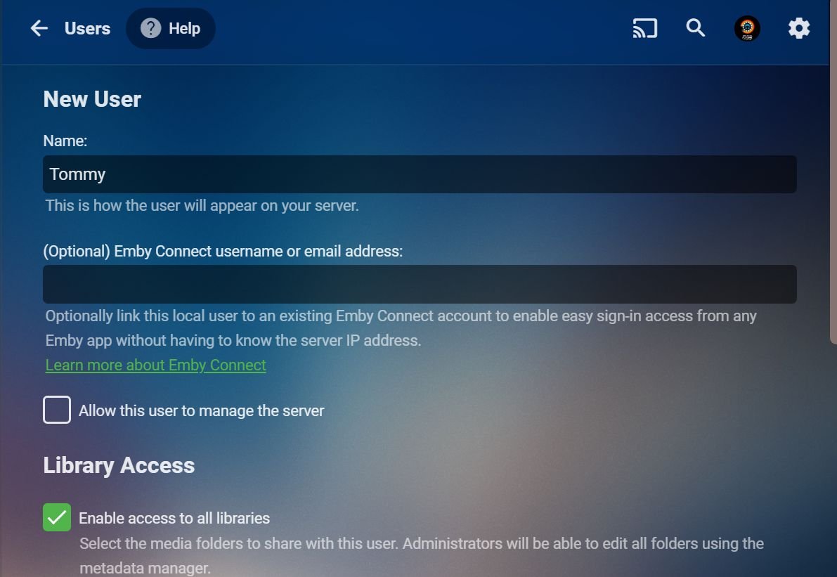

Luke 42203 Posted April 7, 2021 Posted April 7, 2021 30 minutes ago, toolmanz said: Ya, I have had the same problem. I can't send an invite. I had the individual register in Emby Connect. Got a response that all was good. What is the next step??? From a network perspective I don't see how the Emby Connect app makes the connection to my server. I use a reverse proxy to my Emby server through a well known DDNS service and use SWAG to handle the details. I run a PFSense router, as well, on my server which works well. (I actually get close to the 1G service offering ). Does that provide any further details you need? I am running on a Dell R710 server with Unraid - using dockers. We did use Emby connect but there is no option to send an invite. Seems this is an ongoing issue for several users. Thanks in advance toolmanz You simply create a user on their server, and enter their emby connect email address into the second field on the screen where it asks for that: https://support.emby.media/support/solutions/articles/44001160340-emby-connect Please let us know if this helps. Thanks. 1
clarkss12 304 Posted April 7, 2021 Posted April 7, 2021 (edited) 11 hours ago, Luke said: You simply create a user on their server, and enter their emby connect email address into the second field on the screen where it asks for that: https://support.emby.media/support/solutions/articles/44001160340-emby-connect Please let us know if this helps. Thanks. Thank you, that was the key to answer my question. It appears that all the new user has to do, is create a connect account, then the rest falls into place.... https://emby.media/community/index.php?/register/ Edited April 7, 2021 by clarkss12
BillOatman 597 Posted April 7, 2021 Posted April 7, 2021 2 hours ago, clarkss12 said: Thank you, that was the key to answer my question. It appears that all the new user has to do, is create a connect account, then the rest falls into place.... https://emby.media/community/index.php?/register/ Exactly. I just follow the following steps: 1) Have person create an account at https://emby.media/community/index.php?/register/ 2) Send me their username. 3) I create their user, putting the Emby connect username in that Optional field and set what they have access to etc. 4) Tell them to connect as a test. Done.

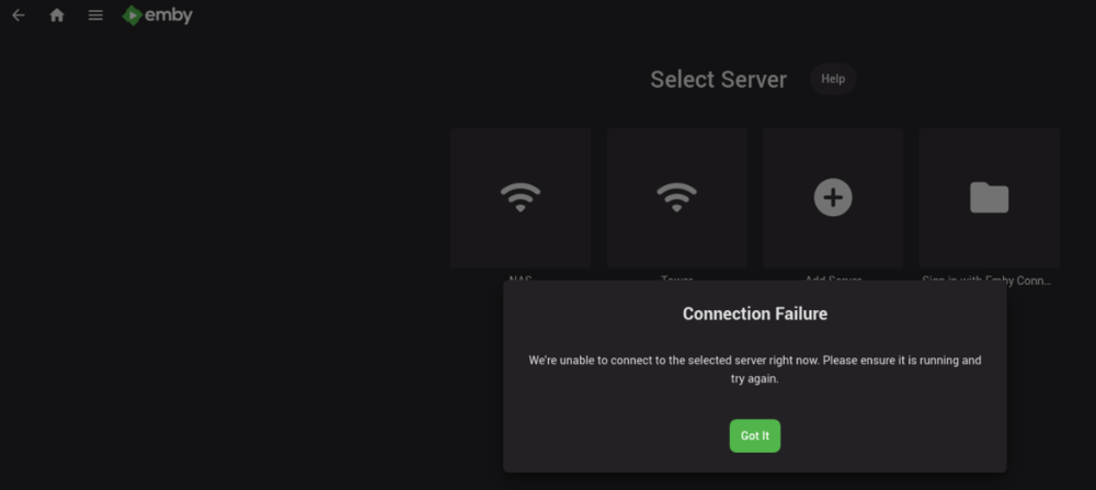

toolmanz 3 Posted April 23, 2021 Author Posted April 23, 2021 Ok, fianlly getting back to this .... my son still can't access the server. (By the way my Emby key expired yesterday - no warning - no email-no nothing. I have purchased a lifetime key but I have yet to receive my key in an email. How long does this take? I purchased this hours ago....I did email the billing support address. Nothing yet..) Just one more thing to contend with..... All of the next stuff happened before the key expired. So thats not it. I went through the step by step (including having him register for connect, added him to the user list etc. Now when he tries to log in, he gets this: It doesn't seem to find the server. The server is running and my daughter can access remotely no problem. We have tried a PC, phone and Firestick. Same result. One thing is odd, when he is on my WIFI, same network as my server is on, his phone connects. Are we sure there isn't something on the server side that needs to be done? My Emby server is on a reverse proxy ....perhaps he is getting the <local> address instead of the proxy address??? I'm running out of options here. Thanks toolmanz
Carlo 4561 Posted April 23, 2021 Posted April 23, 2021 If you used the same email address it will be the same key so nothing for you to do or change. Ca you properly get to your server from the Internet using your domain or IP (not Emby Connect)? If so can you login in with the local username and password (not Emby Connect)?

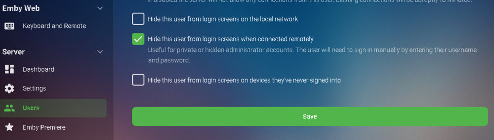

Carlo 4561 Posted April 24, 2021 Posted April 24, 2021 There are settings that you can use to control if a user is shown for local AND remote on the login screen. For the Emby Connect login try this: Remove the optional Emby Connect username from your USER account Click save button Add the optional Emby Connect username back to your USER account Click save button Retest login in with Emby Connect and let us know if it now works. Thanks
