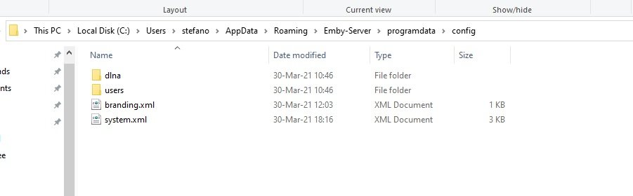

sonusfaber 17 Posted May 20, 2021 Author Posted May 20, 2021 (edited) Nothing at all. I also searched for this file over the disk... nothing. In the config folder there are just 2 file: - branding.xml - system.xml Is this the correct directory? - Edited May 20, 2021 by sonusfaber
Carlo 4561 Posted May 20, 2021 Posted May 20, 2021 What about folders? Do you see other folders in that location? If not it sounds like you might have some stuff hidden because there will be more stuff in that folder. What's the date modified show for the system.xml file?
