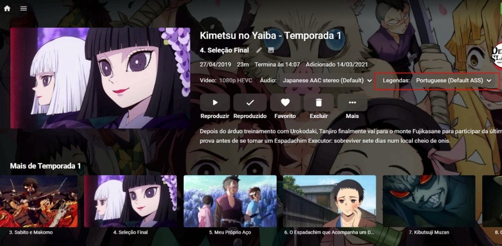

HeroLeam 11 Posted March 31, 2021 Author Posted March 31, 2021 6 minutes ago, cayars said: OK for episode 4 can you play it back, then upload the server log and any ffmpeg file generated? You can find these log files on the Logs menu in web admin. I took a screenshot of the screen with the selected caption, just to confirm, and the file is attached ffmpeg-transcode-adc9ce0d-f931-4217-9f9c-b708e3321c7d_1.txt 1

Luke 42203 Posted April 1, 2021 Posted April 1, 2021 8 hours ago, HeroLeam said: I took a screenshot of the screen with the selected caption, just to confirm, and the file is attached ffmpeg-transcode-adc9ce0d-f931-4217-9f9c-b708e3321c7d_1.txt 23.19 kB · 0 downloads Hi, can you please attach the emby server log as well? Thanks.
