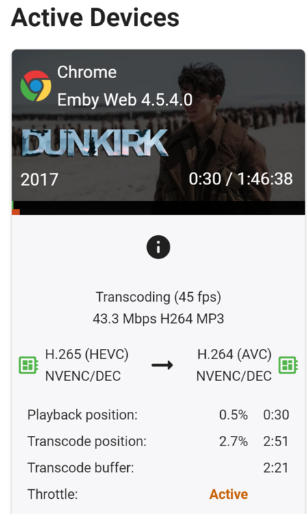

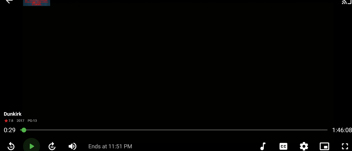

Pukerud 1 Posted March 27, 2021 Posted March 27, 2021 (edited) Hi When transcoding 1080p content every thing is fine and plays smooth. When I transcode 4k content it stops after a set amount of time. It is different for every movie, some movies run for 50 seconds some less. If i switch to software transcoding it works, but then I get a high amount of CPU load on the server. Lets use Dunkirk as a example. It is a 4k HVEC file that starts transcoding if i play it in a browser, if i run it with hw transcode it allways stops after 29/30 seconds. The player in the chrome browser just goes black and video stops. I can see the UI and go back. But pushing play again do not do anything. I have tried restarting Emby, Restarting the machine EMBY is running on. Installing the latest NVIDIA driver. It is a AMD system. CPU: 3600x GPU: Nvidia 1060 3gb GPU OS: Windows 10 embyserver.txt ffmpeg-transcode-e753e2d2-e090-4825-868c-43e3bb7985ae_1.txt Edited March 27, 2021 by Pukerud added OS
