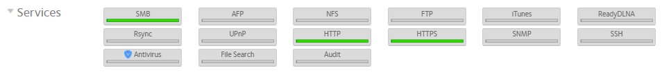

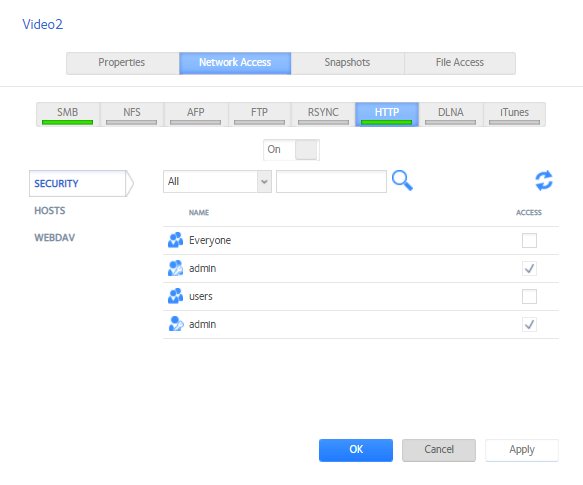

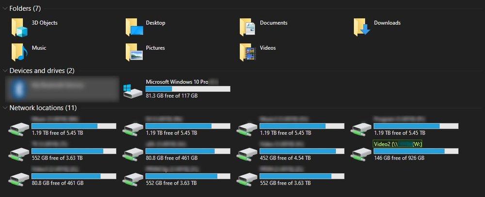

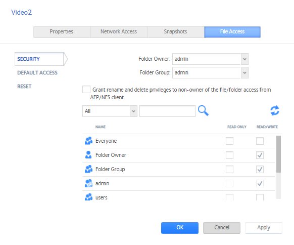

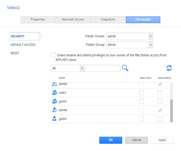

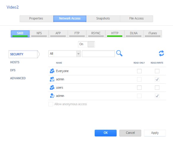

Guest Posted March 30, 2021 Posted March 30, 2021 (edited) Okay.. Dell 7040 Micro Windows 10 Pro <--> NETGEAR ReadyNAS 316 I should be using another account for access with permissions set a little differently, as it is right now I am signed into my NAS shares as admin.. with a good password. You are seeing the Admin Console screens of the Video2 Share that is one a small drive I have. I have disabled most protocols and I am using only the ones I need as you will also see. I opened Windows Explorer (Win + E) and under the Computer Tab, I mapped a network drive... It asks you for a drive letter and location of the share, you have an option to reconnect at sign in, and Connect using different credentials.. You can use those according to the set up you desire. If you look at my Windows Explorer under Network locations... Instead of going to Network.. You can go to those locations and reference or access your files. ( You can also mount drives to other online storage as well ) Your computer manages the access to those drives, with the logon credentials. BUT you no longer are exposed on your network, by the NAS shares. IF Emby is installed on the NAS, then you have to allow Emby access to those shares as after a reboot.. The account for emby as a user will show up.. and its access has to be selected for it to mount the shares as a library. With Linux it has been so long.. that I would not be the one to give you the specifics.. BUT The NAS is Linux OS based.. as well as the filesystem... and shares as shown on the NAS internally.. I have blurred out the actual NetBIOS name of the unit and drive letters.. I can show the fact each one is allowed to be mounted as a library in Emby (without special permissions) with both locations Network drive Letter/path and backup SMB location. System manages access. I had the same idea in the beginning as far as setting up an account in the NAS specifically for READ Only access to the file repositories while running the server on Windows 10 Machine... That way access could be more secure and specific. While retaining my admin account for other operations per due course. Edited March 30, 2021 by Guest
