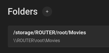

redtr 3 Posted March 26, 2021 Author Posted March 26, 2021 Hey, that seem to have helped! Thanks! I guess this narrows down the issue to the streaming, is there any way I can help to investigate that further? I found this older thread that sounds like same thing and if so, I guess this is a recurring issue. For future reference if anyone else encounters this issue: 1. I have added an optional UNC path to my library like so 2. Enabled "Pass Direct Path" in the Emby client's Playback settings 3. When the video is playing the Stats box shows "Stream type: File" 2

Carlo 4561 Posted March 26, 2021 Posted March 26, 2021 No I meant if you setup the library with: F:\Movies then you will need the optional UNC path filled out to play back directly via file mode. However if you originally setup the library with" \\EMBYSERVER\F\Movies or a UNC path then there is no need to fill in the optional UNC path.
redtr 3 Posted March 26, 2021 Author Posted March 26, 2021 My network drive is mounted using the Shield's "Mount network storage" menu to /storage/ROUTER/ so my library paths look like /storage/ROUTER/root/Movies.
redtr 3 Posted March 27, 2021 Author Posted March 27, 2021 Ah, so that's expected? This article led me to believe I need both the mounted storage and the optional network path specified. Good to know, thanks!
