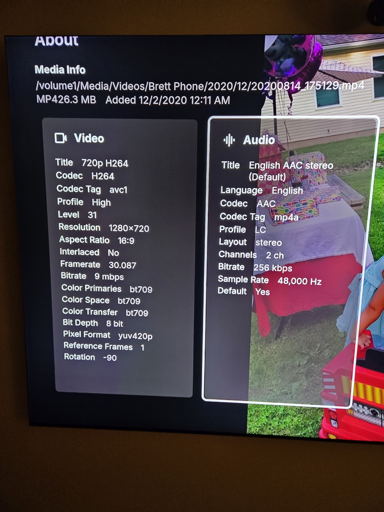

SamES 1084 Posted September 4, 2024 Posted September 4, 2024 23 hours ago, bmflagg said: Morning Sam 1 video is actual video, the other is from my phone which shows what happens on the TV when you play it. If I play the actual video outside of Emby on Samsung, it plays just fine. Bret Can you confirm the server version? Have you tried refreshing the metadata for this file on the server, then retesting? Please confirm if it is DirectPlay, DirectStream or Transcode during playback? Please also attach any log files created during the test, preferably with debug logging enabled. Thanks

bmflagg 21 Posted September 10, 2024 Posted September 10, 2024 (edited) I Server is 4.8.8 Software Encoders are default (H.264 and h.265) Attatched the log file.. near the bottom where you see the ========== is where it starts. As for transcoding, direct play etc... , I can't find it in the admin portal, but I just accept the defaults during installation if that helps. Server is currently on a QNAP box.. The cell phone take with is a Samsung S21 I believe at that time. embyserver.txt Edited September 10, 2024 by bmflagg

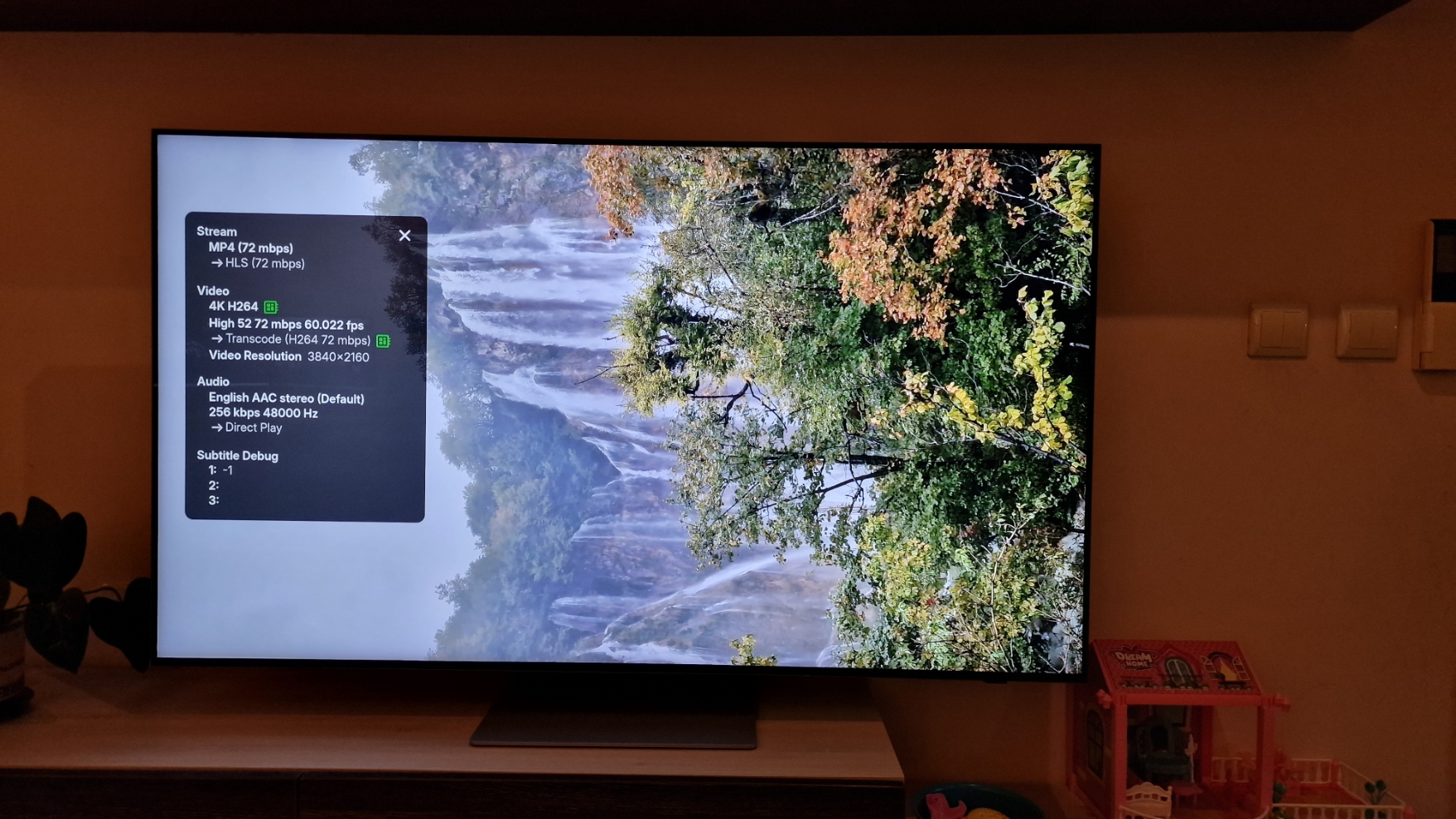

tsvetelin 1 Posted October 18, 2024 Posted October 18, 2024 It's past the end of September, so I was eager to get the new version. I am with the 4.8.10.0 server and sideloaded 1.9.0 onto the Samsung TV. Vertically shot videos are no longer smashed, and the aspect ratio is honored BUT the video is rotated, so in this video of a beautiful waterfall, the water flows from left to right, not from top to bottom. I logged out, logged in, rescanned the library, and rebuilt the metadata - still the same.

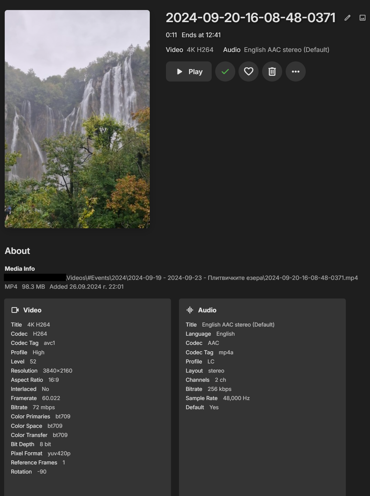

SamES 1084 Posted October 18, 2024 Posted October 18, 2024 Can you please show the media info at the bottom of the details page for this video?
tsvetelin 1 Posted October 20, 2024 Posted October 20, 2024 On 10/18/2024 at 11:45 PM, SamES said: Can you please show the media info at the bottom of the details page for this video? This one?
SamES 1084 Posted October 20, 2024 Posted October 20, 2024 5 minutes ago, tsvetelin said: This one? Thanks
SamES 1084 Posted October 21, 2024 Posted October 21, 2024 On 19/10/2024 at 07:14, tsvetelin said: I am with the 4.8.10.0 server and sideloaded 1.9.0 onto the Samsung TV. I think we still need some updates on the server. Can you please upload (or PM) the log files for this test with debug logging enabled. There should be a server log and ffmpeg log.
tsvetelin 1 Posted October 22, 2024 Posted October 22, 2024 On 10/21/2024 at 1:37 PM, SamES said: I think we still need some updates on the server. Can you please upload (or PM) the log files for this test with debug logging enabled. There should be a server log and ffmpeg log. I sent them in a DM.

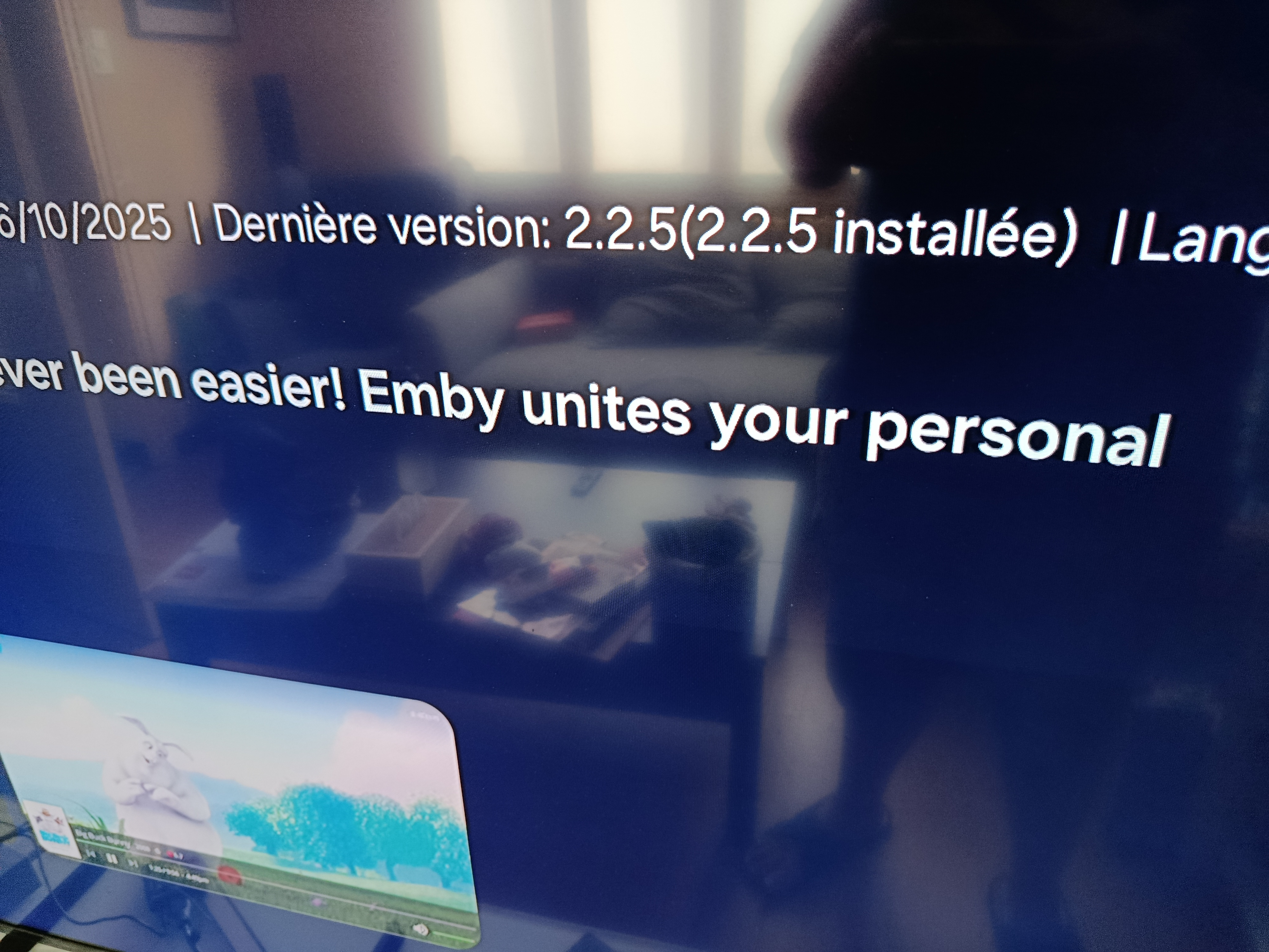

SamES 1084 Posted October 31, 2025 Posted October 31, 2025 @KarlHungus67can you please confirm the App version on the TV
KarlHungus67 9 Posted October 31, 2025 Author Posted October 31, 2025 4 minutes ago, SamES said: @KarlHungus67can you please confirm the App version on the TV Hi, 2.2.5 (from official store)
