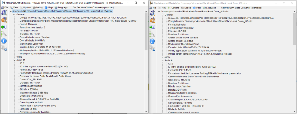

jrwalte 17 Posted March 22, 2021 Posted March 22, 2021 Had a weird issue last night when trying to watch a 4k MKV of Black Hawk Down with TrueHD track. It would play fine then the audio gets a blip or skip. When it would blip, the audio is just barely off. But when it skipped, the audio would be off 1-2 seconds. Stopping and restarting or rewinding would get it back in sync. Then it would do it again. Rinse and repeat through the whole movie. I haven't experience this issue before. Thought maybe it a network or hardware issue. Rebooted everything in the chain. Still occurred. Played another 4k TrueHD John Wick for 30 mins and had no issue. Went back to Blawk Hawk Down and it started again. So I'm thinking it is something with the TrueHD track of Black Hawk Down specifically? I also noticed at one point in the movie the center channel became over amplified in the recording and was distorting, even though it wasn't any louder than before (so it was a recording issue not my speaker). Can you see anything happening on the server or client side? I'm using AndroidTV 1.8.80g on Nvidia Shield Pro 2019 with server 4.5.4.0. Server log attached. AndroidTV Emby user is 'Justin'. No transcoding was occurring. I was watching last night 3/21/21. Below are time stamps in eastern daylight savings. 9:03 pm 9:04 9:06 9:08 9:26 9:27 9:40 9:41 9:46 9:49 9:50 10:06 embyserver-63751967999.txt
ebr 16338 Posted March 22, 2021 Posted March 22, 2021 Hi. It may be a bitrate thing but did you send a log from the app? I don't see one at those times.
jrwalte 17 Posted March 22, 2021 Author Posted March 22, 2021 SMH. I reinstalled the app as part of debugging and didn't turn on the debug option in the app again. I don't think it a bitrate issue. I play plenty of other files with higher bitrate. John Wick I tested last night during the same time is a higher bitrate. I'll have to play it again.
