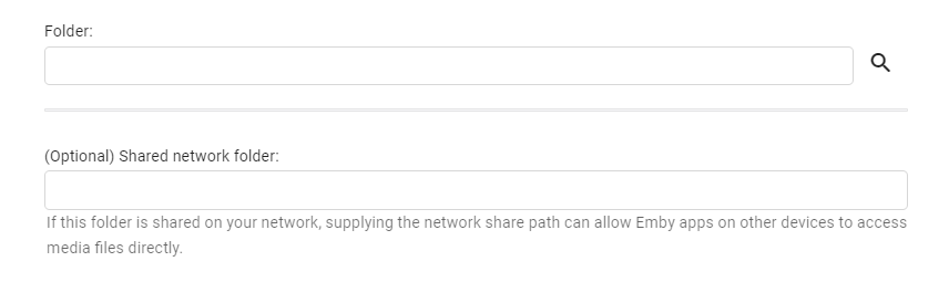

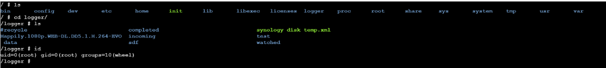

ryzilla 13 Posted March 22, 2021 Posted March 22, 2021 Hi Guys Having some issues here with docker (running on linux) and NFS. I have added a volume that i mounted in via the cli i can see the files and the share dont mind root as i was testing here. But when i try add the share into Emby it just never works then it goes to I must be doing something wrong if anyone can point me in the right direction.

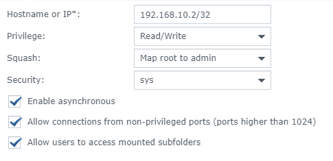

Solution ryzilla 13 Posted March 22, 2021 Author Solution Posted March 22, 2021 Fixed it, dumb on my side, i had to in the synology map the NFS user not secure but will do for the mce side of things.
