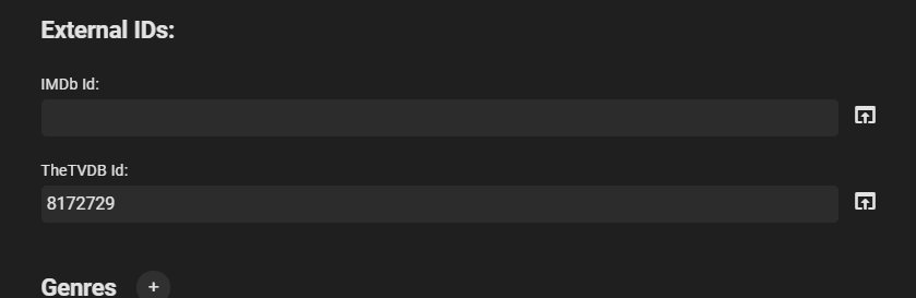

ulTimaS 0 Posted March 30, 2021 Posted March 30, 2021 (edited) 15 hours ago, Luke said: We do, if that value is in your server metadata. Is it? I do have it selected on my server, but if I look at the metadata on the episode itself it doesn't show a TMDB id unless it's a hidden one. library settings: individual episode (shameless s11e10): Edited March 30, 2021 by ulTimaS
